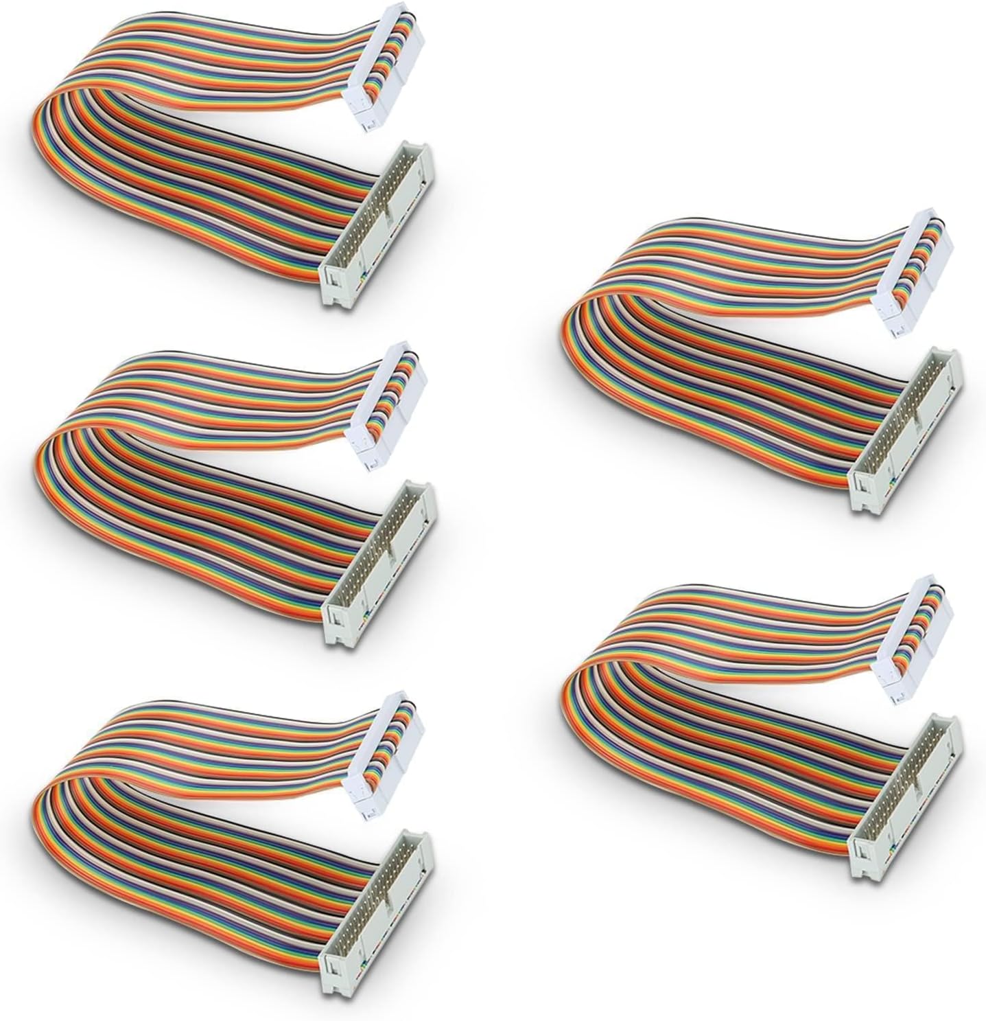

This one worked for me:
Great! I found it on Amazon (easier for me) with the term “hat ribbon cable”. It was not the first answer, though.

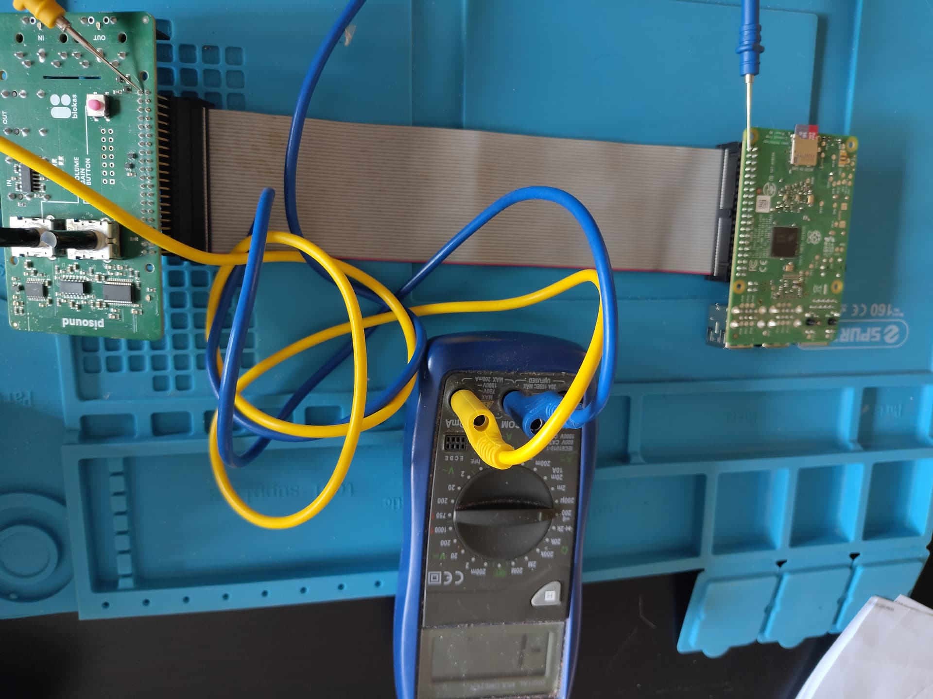

Here is what I got. I don’t know if it is well visible but the multimeter is ringing while it is not the expected pins that are touching.
This ribbon cable was connected to a device allowing to connect the gpio to a breadboard.
This connects the bottom (female) side of the Pisound’s connector with the top side of Raspberry Pi connector, so the mirrored rows would be expected. Ribbon cables like these are usually meant to connect two male header pins. If it was possible to connect it to the top side of Pisound, the rows would match up.

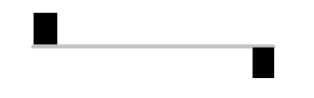

It is possible to build a custom ribbon cable with one connector looking up, the other looking down, then the rows would match up in female ↔ male connections, here’s a crude side view of such a cable:
The one I bought from Amazon works great. Thanks to all for your help.
Could you link the one you got here? Just in case anyone else would be interested in getting the same kind of cable.
Yes! Here it is
