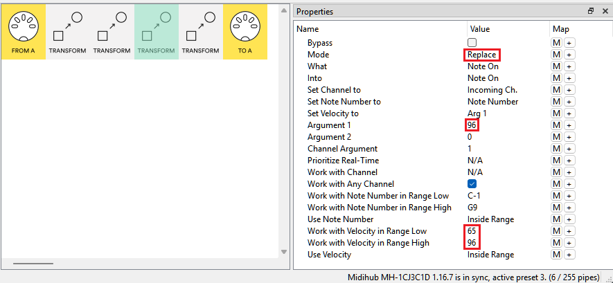

Another (not very elegant) way if you want exact input ranges and output velocity, Transform Pipes that replace velocity in range [a; b] with [b] will work:
