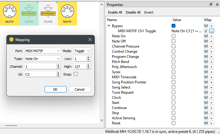

Problem when using same Note On Toggle Mapping in different presets
When I use the same Note On Toggle Mapping in different presets, sometimes the mapping in one preset can mess up the mapping in another.
Simplified example:
Preset 1: Two (dummy) Filter Pipes both with a Mapping that toggles Bypass On/Off by C3 Note On
Preset 2: Same as Preset 1 but with one Filter Pipe removed.
In Preset 1 the two Bypass On/Off’s switches together when hitting C3 as they should. Select Preset 2 and press C3 an odd number of times. Go back to Preset 1 again and press C3 a few times. Now the two Bypass On/Off’s are not “in sync” anymore. (When one is On the other is Off.)
Maybe I’m doing something wrong?
Same_Toggle_Mappings_B
Same_Toggle_Mappings_C
Same_Toggle_Mappings_Preset1.mhp (426 Bytes)
Same_Toggle_Mappings_Preset2.mhp (405 Bytes)
