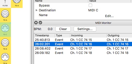

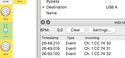

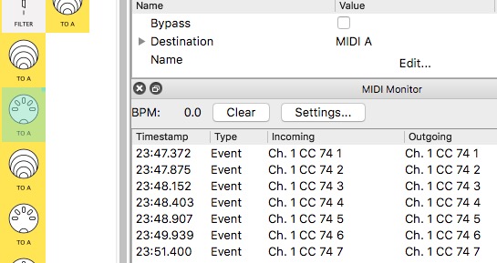

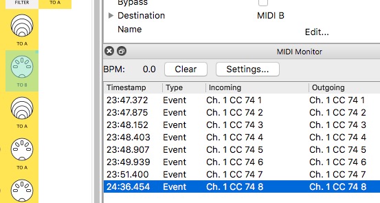

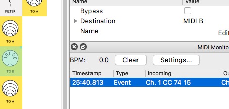

This what I meant by testing it out:
the following shots show the best you can do without a loopback or a ‘settable’ control
now B>
still B>
now C>
but also…>
try it yourself.
Low tech, I’d go for this and some marks on a bit of tape…
