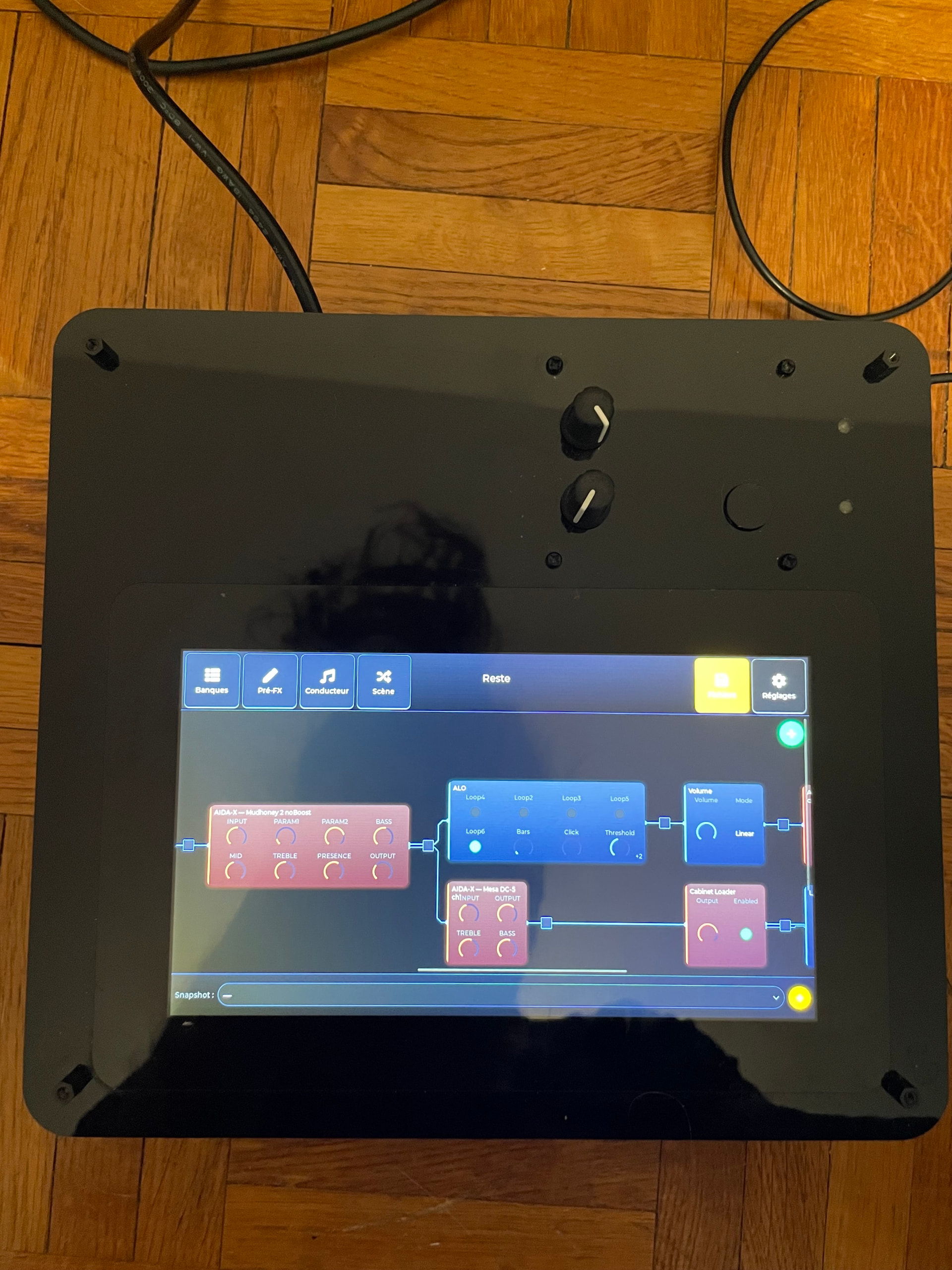

This is a homemade substitute for mod-ui built with LVGL. The development is already quite advanced, not advanced enough to be released though.

This is what I have done for my guitar multi effect, using the official touch screen and the official power supply.
The screen is using the deported pins on the pisound.

Would u like to share with us this version? I manage to add an on-screen keyboard (ipad style) with widget added on the menu bar so u can togle on off the keyboard, so that makes modep searching tab much easyer. But i would like to try youre interface though.
It is still a bit early to be released. Actually I started working on a “install as a patchbox module” but it’s still a work in progress. But we are getting there.
