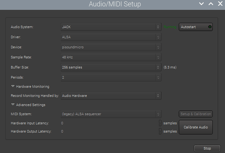

It depends on the MIDI implementation you select, it should be easiest to deal with ALSA sequencer implementation, as it requires no special configuration at all, and works just fine.
Here’s a screenshot of a configuration that works for me:

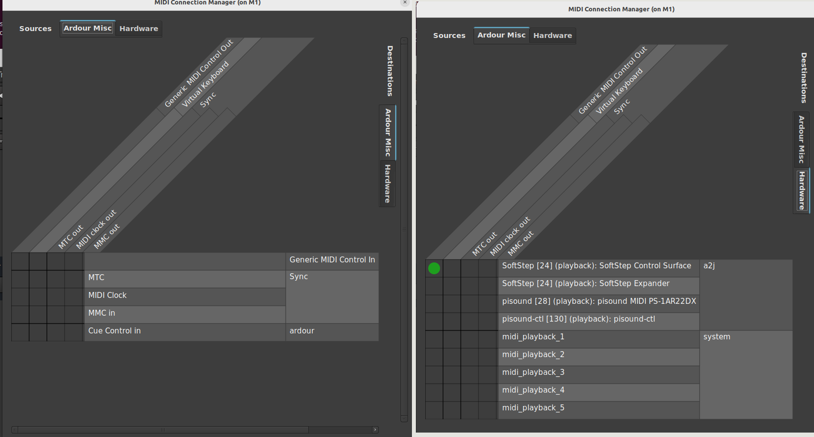

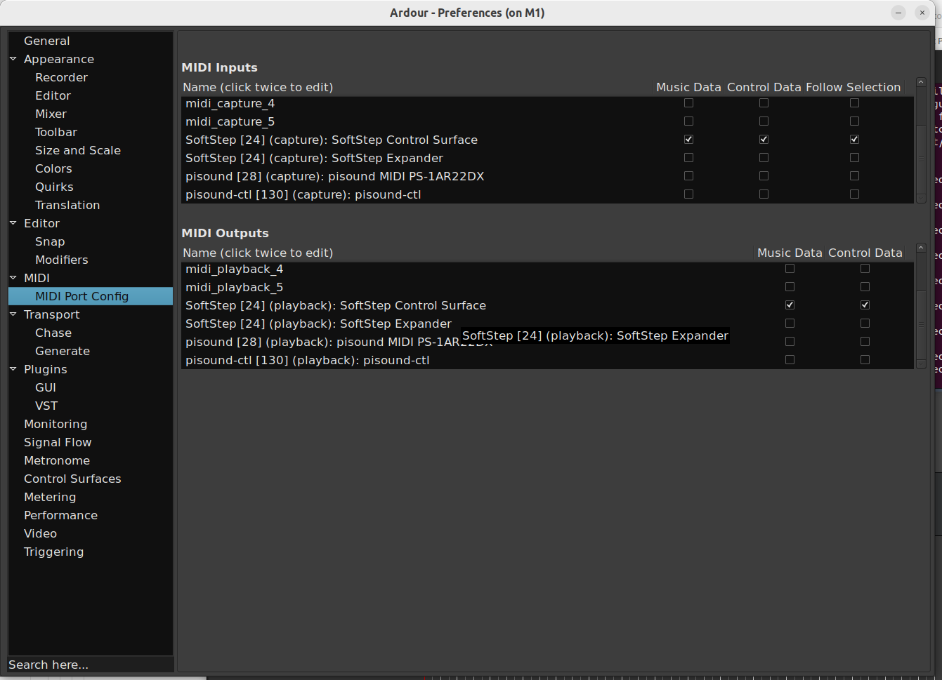

Attached are screengrabs that I find troubling, taken yesterday prior to “the incident”
  1. midi port config
It worries me that there isn’t a binding… The default is “drop bindings” - I’ve left it at that, but that might not be right. There isn’t any hardware in the dropdown list that looks like a softstep
  1. Connection-managers. Output has rows for the softstep. Input doesn’t

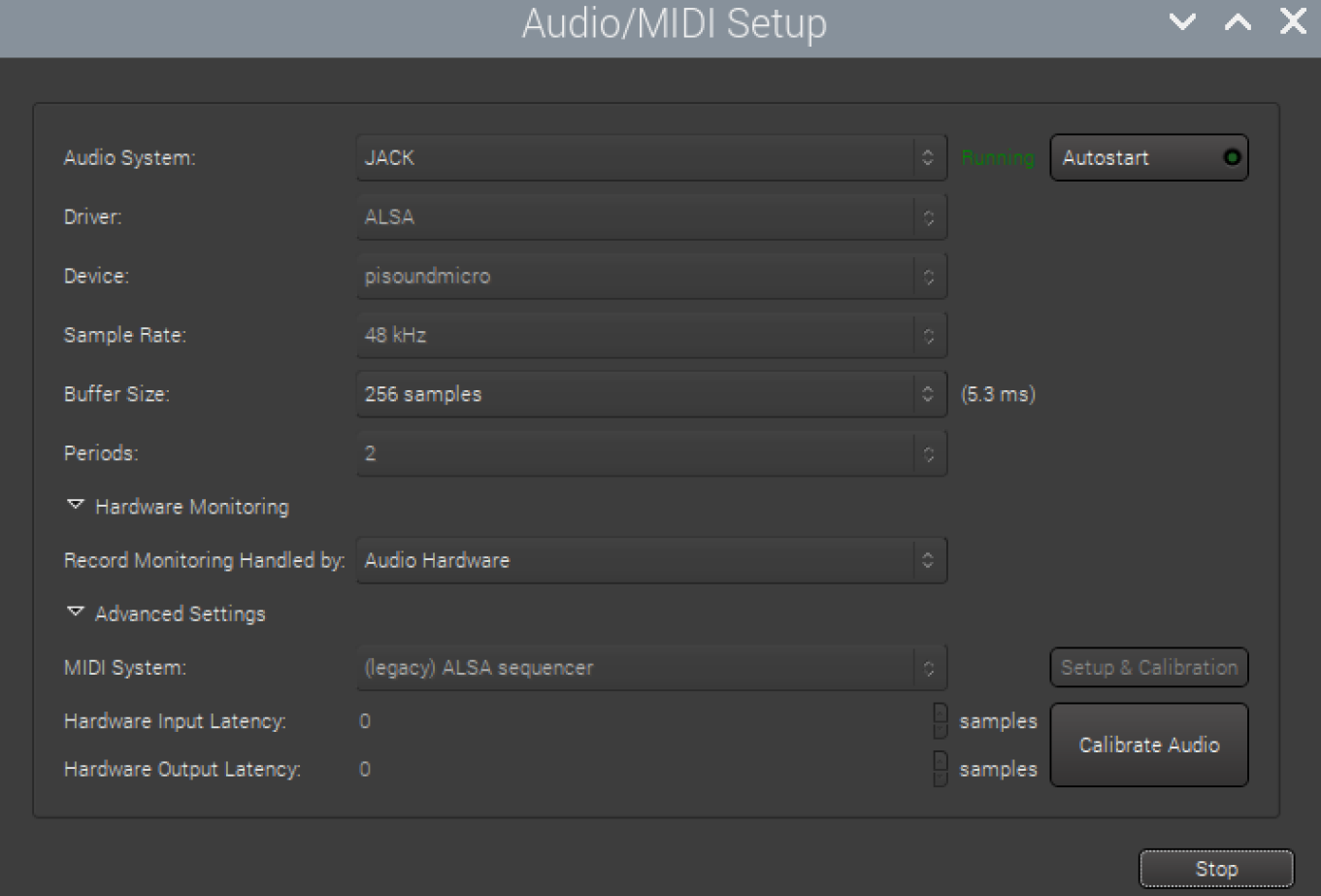

The Audio / MIDI Setup dialog appeared immediately after creating a session at Ardour startup.
Ah, it turns out in case the Jack server is already running, it does not allow you to select the MIDI driver to use, hides these options and forces you to use Jack MIDI implementation.
In that case, you’ll have to go with a2jmidid -e. One of the ways to make it start automatically is to make it a systemd service:
