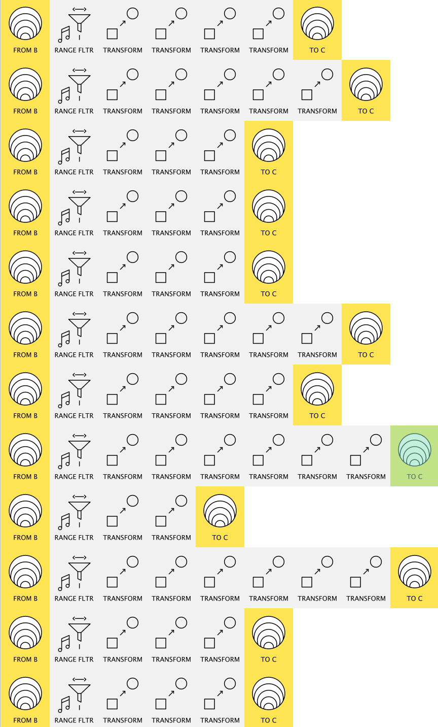

I went through the Transforms so far and put the settings in the Description
here it is for reference
#ch1
B0āC3, C#0āC4, D1āC5, C0āC6
#ch2
B0āC#6, C1āC#4, A#1āC#3, C#2āC#5,
#ch3
A#1āD6, B1āD4, A2āD3, C3āC5
#ch4
A2āD#6, A#2āD#4, G3āD#3, F4āD#5,
#ch5
G3āE6, G#3āE4, F#4āE3,
#ch6
F#4āF6, G4āF4, F5āF3,
#ch7
F5āF#6

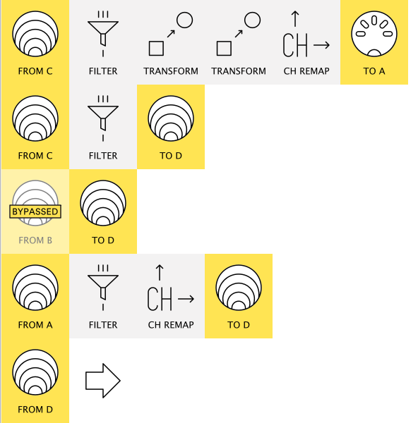

If a Indikationston is not picked up by the banks of Transforms it will proceed with itās channel 1-7 until it reaches the Virtual C ā Channel Remap ā MIDI A line when it is removed

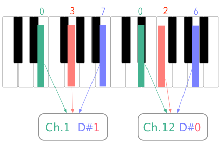

For readers coming to this later, Kleiniās preset now takes any octave of root notes and calculates a unique āid noteā for each tri-chord based on based on the note.
it works as in this hint:
where..
- ..the lowest note dictates the Channel of the āid noteā
- ..the 2nd note decides its octave
- ..and the third note tells us what Note Name the āid noteā uses
This means that the same chord shape will give the same āid noteā, only the channel changes eg:
| chord | gives | id note name |
| Em | ā | Ch1 D#1 |
| Fm | ā | Ch2 D#1 |
| F#m | ā | Ch3 D#1 |

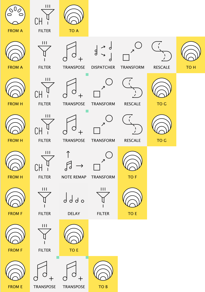

The preset is in four sections
This is the main sectionā¦
ā¦where a tri-chord is turned into an id note.
The four mapped Transposes are the key here
This is the output sectionā¦
ā¦where @Kleini took the id notes coming from his chords and transformed them to the actual notes he wanted.
Note how each line deals with just one Note Number/Name with each Transform handling just one channel.
(We used Poly AfterTouch as a safety measure so no note got re-Transformed)
the third section is just for MIDI monitoring purposesā¦
ā¦to be able to check the incoming chord vs intermediary messages vs id note produced
This can be deleted

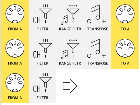

The final section is independent, allowing @Kleini to play bass notes direct from another bank of keys:

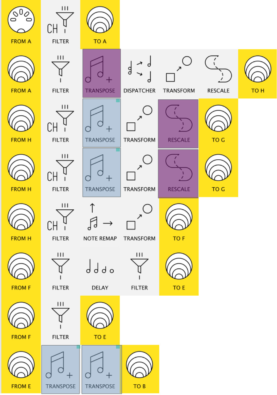

I will add a shaded version of the main section to point out pipes that can be safely modified
for those who want to adapt the preset
Apart from the entry Channel filter, the purple shaded pipes hereā¦
..are the only ones that might need changing.
Change the (unmapped) Transpose so that your lowest possible root note is adjusted up to middle E = 64.
(The whole system pivots around 64 as a reference point so incoming notes are shifted to align with this) -
Change the two shaded Rescales only if your use-case needs different ranges for note 2 or note 3 of the tri-chord
The preset is set so that each Note 2 has a range of 10 notes (on from the root)..
..and each Note 3 has a range of 12 notes (on from the 2nd)..
ā¦this gives 12channels x 10octaves of notes = 1440 tri-chords
Other adopters may prefer different combinations.
(With a little more work, a 4-chord version would be possible with say, 15 x 5 x 5 x 5 combinations)

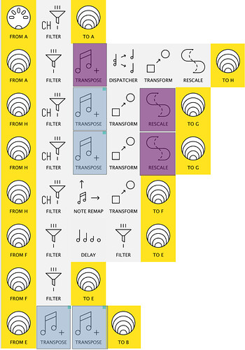

for those who want to decode the preset
The mapped Transposes are the key:
The two Transposes on separate lines modify note 2 & note 3, respectively; preparing the final āoctave + noteā Transposes toward the end of the main block.
Further, see that Note 2 is Transposed according to a mapping derived from Note 1
ā¦
..and similarly..
.. that Note 3 is Transposed according to a mapping derived from Note 2.
It is this technique that gives us the ārelativeā ranges that make this new version work
mapped Transposes are also the reason why 64 is important as a reference point in this system!
