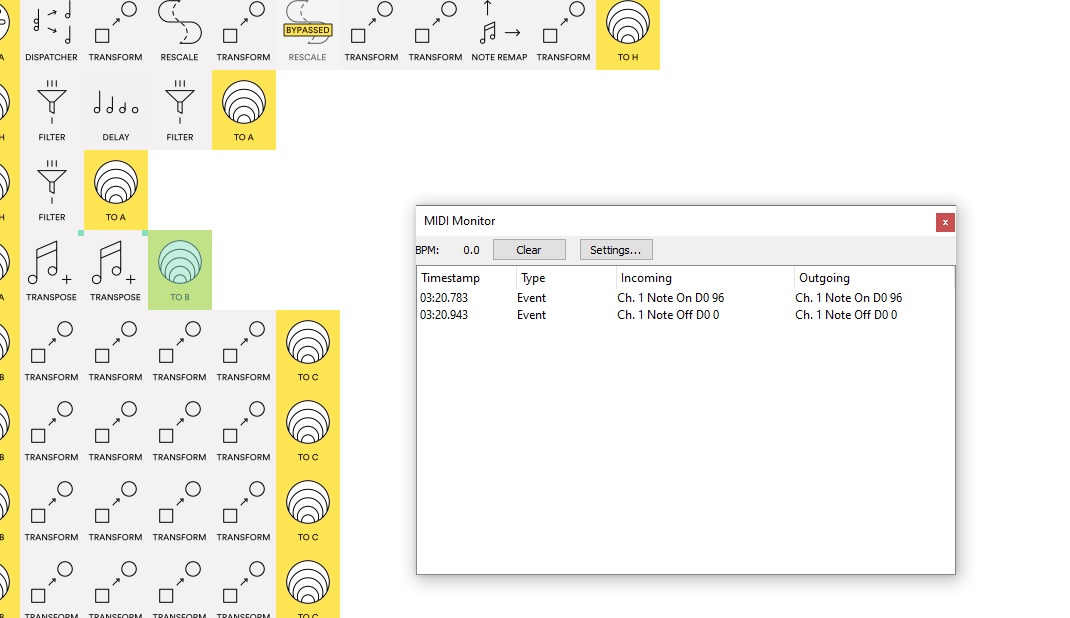

Here is a Video with my Setup auf the Problem with the midihub
Routing: Accordion - Midihub - Miditemp M8 - Soundexpander - Mixer
What are the Channel Remap’s parameters? It’s filtering out the notes from the output, and/or sending them to a different channel than you expect.

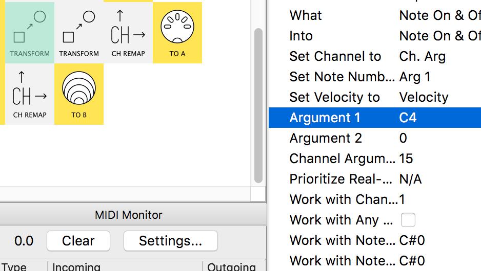

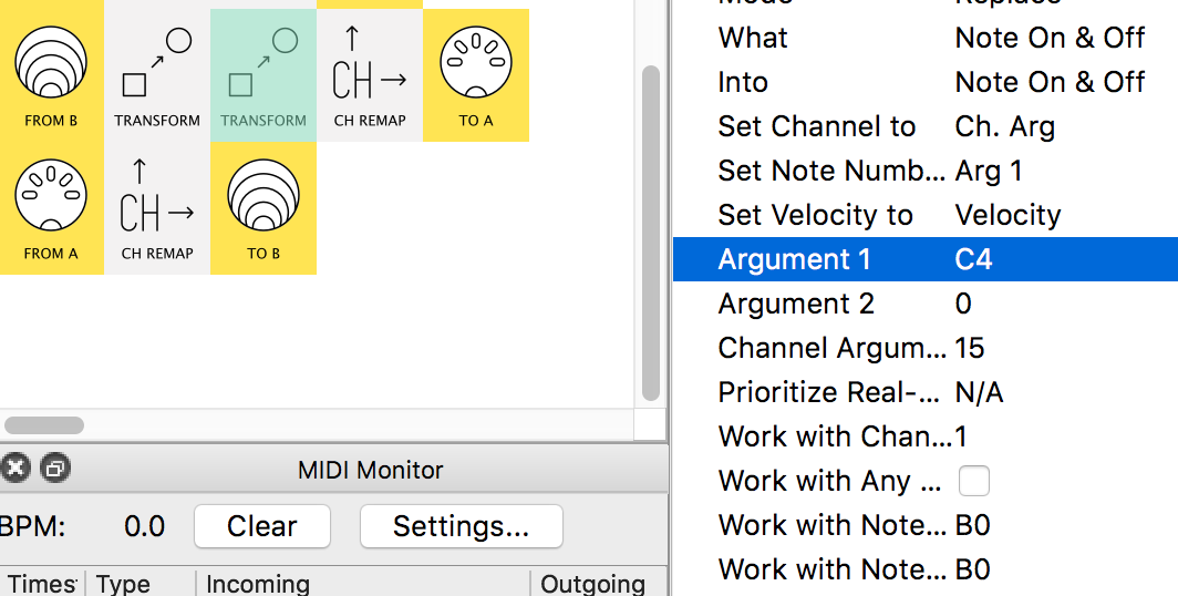

setting your own Transforms
You are correct, both the existing Transforms give the same note which is a mistake.
Look at the Transforms’ parameters
and
Note my error –that both have C4 as Argument 1. So this is where you change to outgoing “true” note.
Note also the Work with Note... parameters lower down are set to B0 and C#0 respectively.
So this is where you set the incoming “chord identifier” note :asterisk:

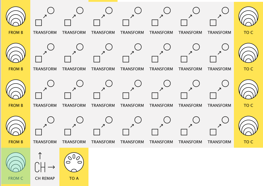

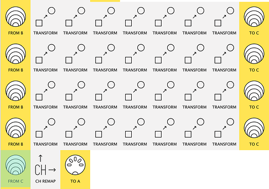

Incidentally, there is no need to put all your final note Transforms in one pipeline
You may wish to group them in some way across similar pipelines:
Here we have 4 similar pipelines all leading to a single Channel Remap.
This is perfectly safe without need for Note Range Filters or Channel Filters. These may add readability, however, when monitoring – depending on how you decide to organise the work.

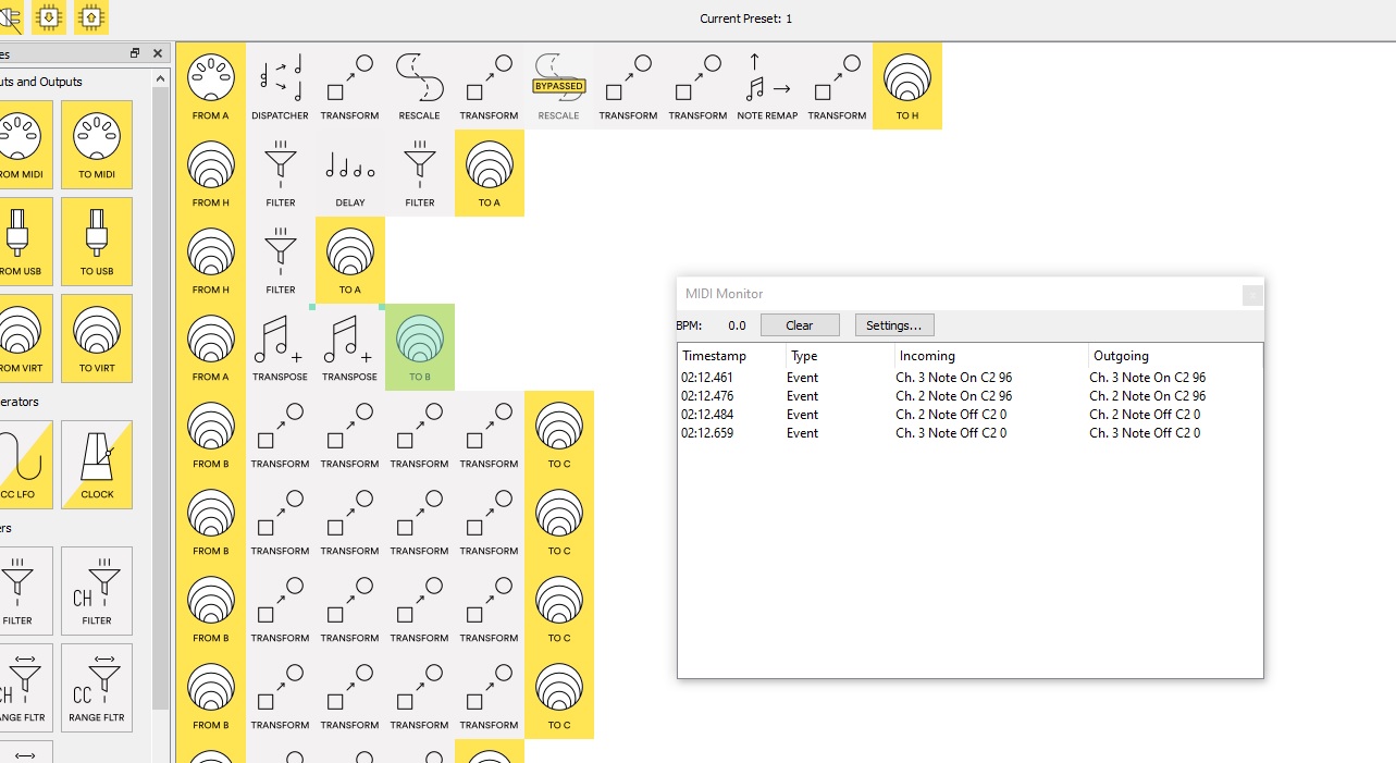

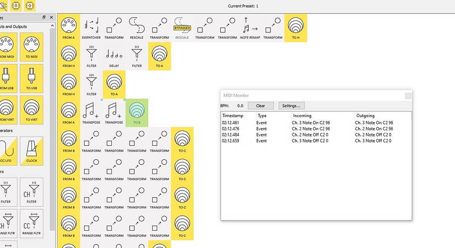

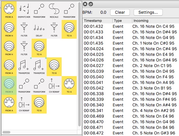

Have you tried this yourself?:
watching MIDI Monitor as you play a chord and seeing what (Ch1-9) Indikationston follows the Ch16 triad notes?
as in this pic I showed you yesterday

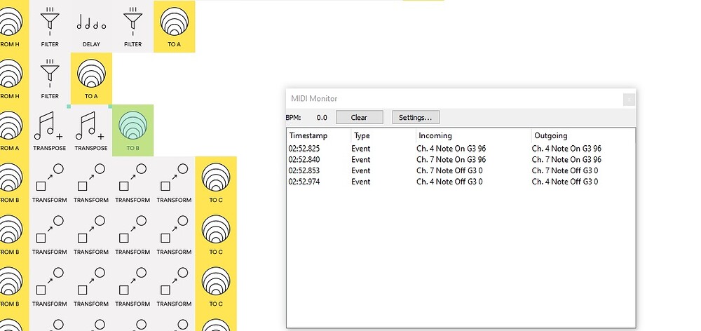

Useful info; I noticed in @Kleini’s screenshot pdf in an earlier post, there were a couple of stray notes so it’s reassuring to know that the counter won’t get upset.
I haven’t tested on single notes, though, presumably they will get through with no extra notes to reset the Transposes? Hmmm…
I finally had time today to focus on this topic again. I created a list of all the accordion notes that sound on each button, along with the indication tone and the note that should be played in the corresponding octave. Once the list is complete, I will program the Midihub accordingly.
At the moment, I have started reading out the first three buttons of row 1. For buttons 1 and 2, the program currently produces two notes—actually, the notes are the same, but the channel is different. Is this a problem?
I tested what happens when I enter channel 2, and the result is different from when I enter channel 3. Is it possible to reprogram the system so that only one indication tone is generated?
2025-03 Midihub indiaktionsnote Gitarre.pdf (48.1 KB)
No this is by design: the Note plus Channel pair is needed to give a unique identification.
