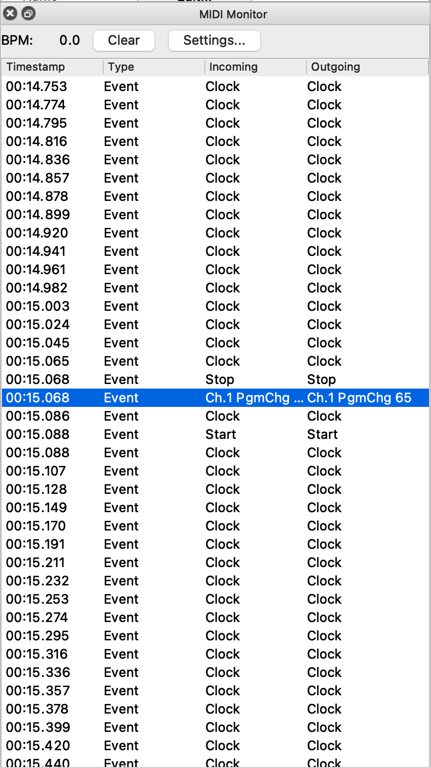

So here a Screenshot from Midi Monitor

The sequence of events seems to be as expected - there’s a Clock event between the Stop and Start events that the Elektron device would have missed during the requested Program Change, but the Sync Delay compensates for it immediately after Start event goes through it, and then the Clock events continue in roughly 21ms period.
In theory, the devices should remain in sync.
