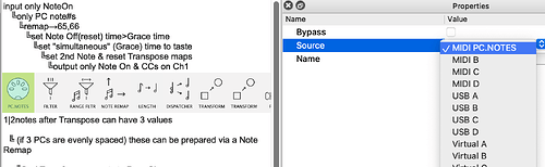

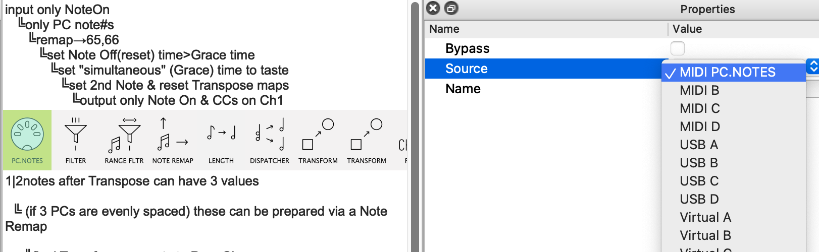

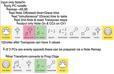

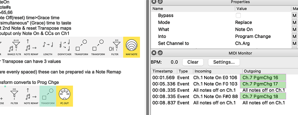

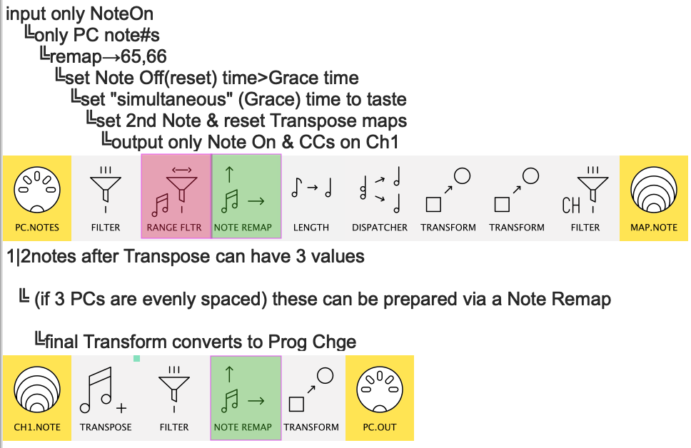

Hey @choponster01 here’s the first draft of a neater version:
two_note_combinations>uniqueProgChange.mhp
Notes
the inline comments give a sense of the steps taken…
…but a better understanding will be gained by Monitoring each pipe as you enter notes

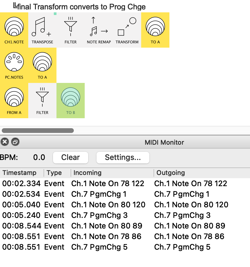

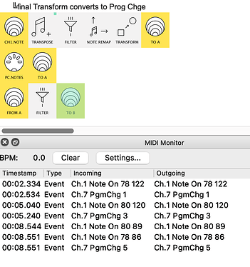

Here’s the input alongside the output in a version adapted for monitoring the I/O:
(note how, when a single note is hit, the Ch. 7 PgmChg isn’t output until after the Chord Grace Period is elapsed)
See the Preset Description panel for more.
The core approach here lends itself to two note combinations of several notes – say 4 adjacent white keys.
This version will need CC Table for the I/O conversions so it’s slightly longer.
I may well publish this soon (along with more explicit details on how/why it works :smiley:) for more general use

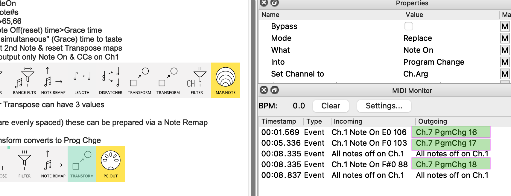

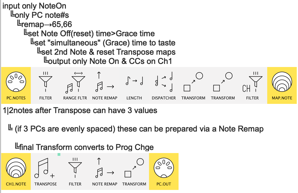

Adapting the “two_note_combinations>uniqueProgChange” preset
  1. now we know your incoming notes are adjacent…
    …so you can delete the Note Range Filter
    You will…
    …delete the red, edit the green!

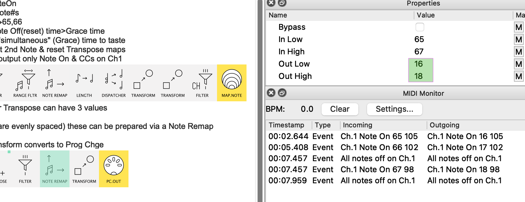

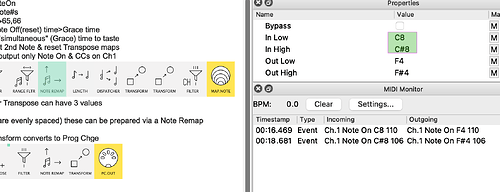

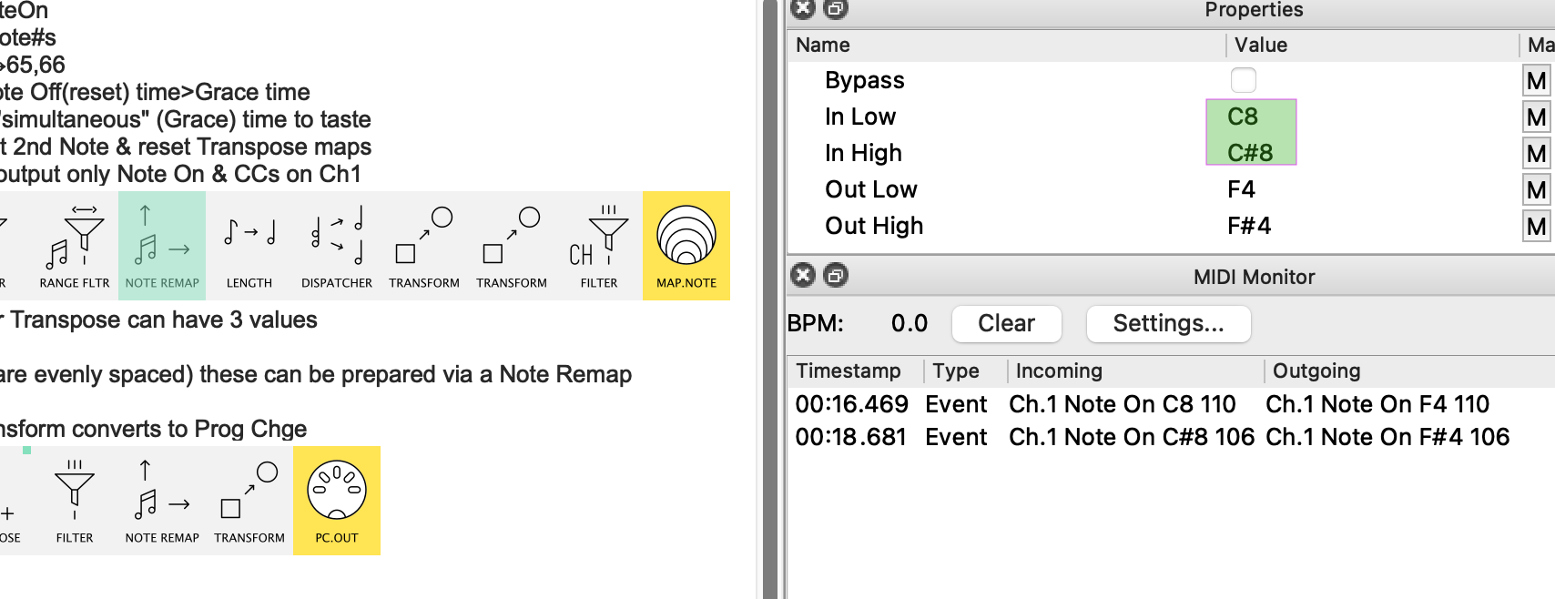

  2. In the first Remap, set the Incoming range to yours:
    (leave the Outgoing range unchanged)

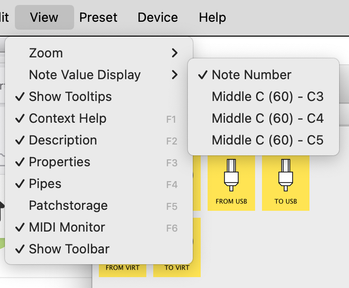

  3. Before changing the second Remap, switch to Note Number display…
    …then set your outgoing range to fit your PC numbers:
  4. Now observe the Program Changes created in the next Transform:
  5. Make sure to correct the channel (mine is set to Ch.7)

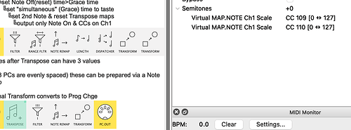

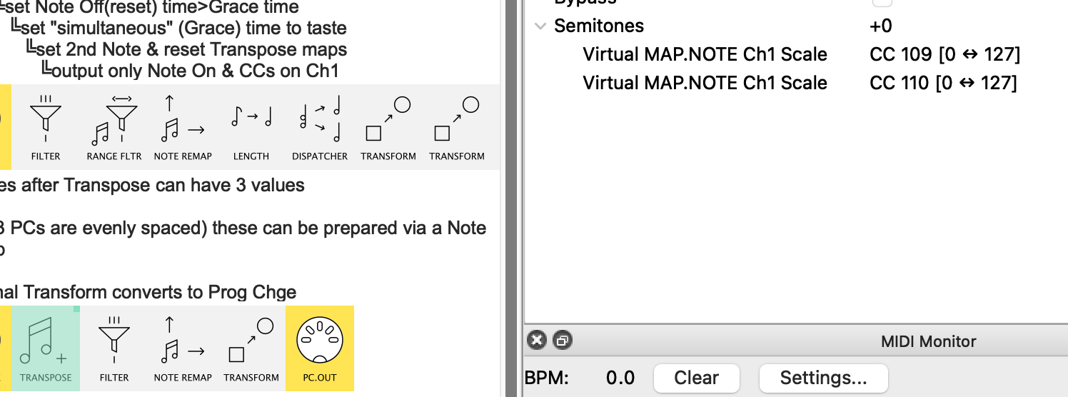

transform changing to a Control Change
The CCs create the mappings to change the Transpose.
Just as a test:
  • if you make the Length much longer than the Chord Grace Period
  • and watch Transpose when both keys are pressed
  • you will see the Transpose change to +2
  • then back to +0 when the CC from Note Off is received
In short,this mapped Transpose is what makes the simultaneous note aspect work
