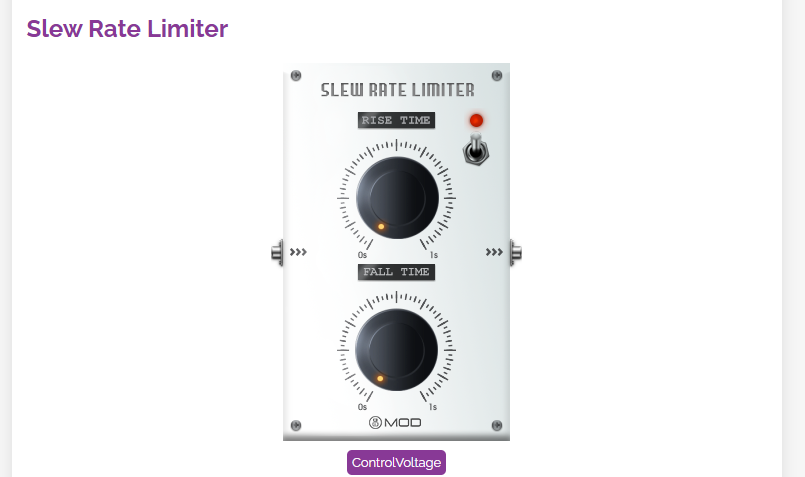

Hello. I could not find the slew rate limiter plugin in modep Patchstorage. I can see it in Mod Audio plugins. Sorry I am new in Modep. Is there a way I may get this plugin in my Modep?
Slew Rate Limiter - MOD Audio
