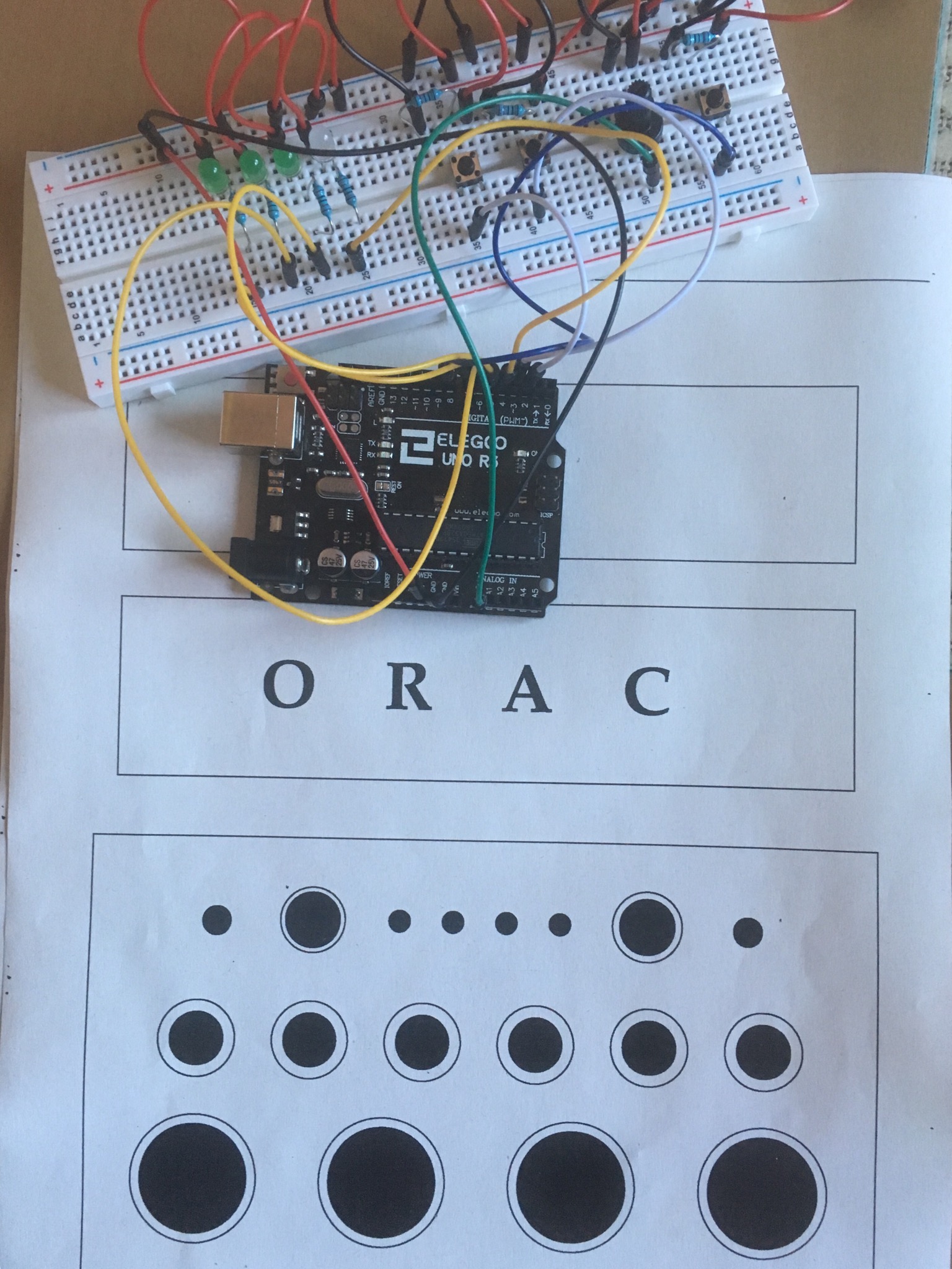

I have more or less the prototype and the design for the box. To say that I do not have any Arduino experience and it’s my first project, that’s why I think that anyone can do it. It is a midi usb controller with 4 banks, one for the three chains and one for the post effects. It can also be used with other software but I have focused it on Orac. Cheers.
