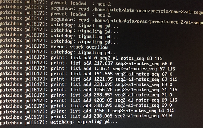

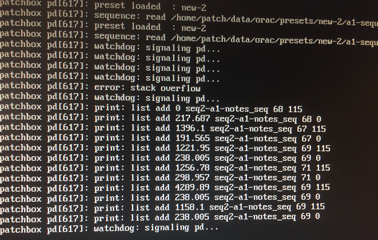

This has been useful to try and troubleshoot. I have a patch with SEQ2 in A1 and Analogmono in A2.
I press my AUX button which is currently a MOMENTARY sending 0 or 127 on #69.
First time press after loading the patch I get a stack overflow.
If I hold the AUX I can see Journalctl getting the notes.
When I let go it plays the first 2 notes and then stops.
Any ideas what i’m doing wrong?

seq2 - aux
long hold of aux (2 seconds?) - arms recording , but will start recording when you play first note
press aux will then stop it
short press = play
(stack overflow error is a red herring)
seems to work for me, but I admit its harder to know what ‘mode’ you are in without a screen :wink:
(organelle, tells you its armed etc)
aux can be used differently in different modules/patches (remember many modules were derived from c&g patches) , but often a long hold is some kind of ‘clear’

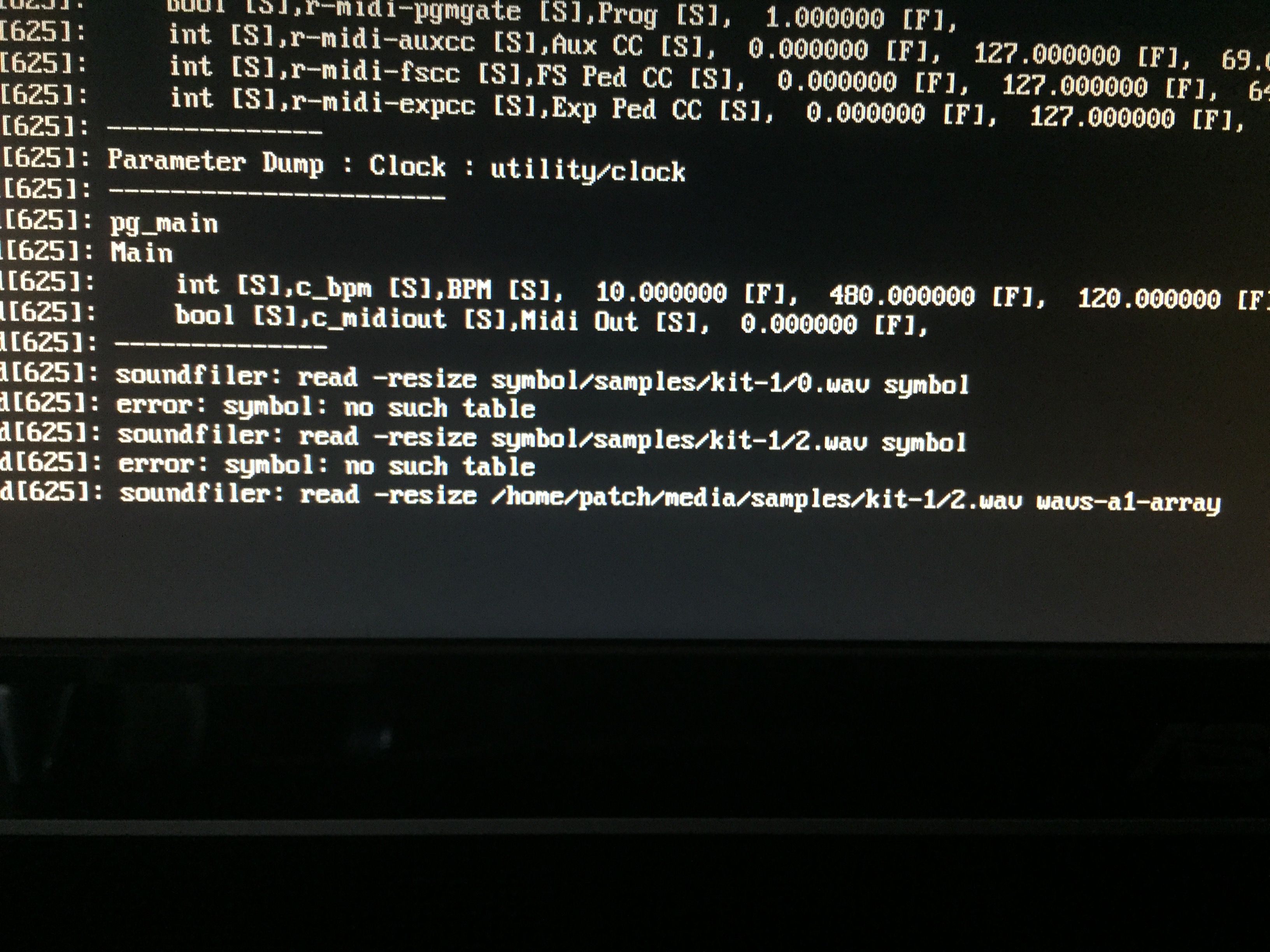

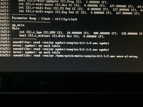

Also Mark I got the following error from Wavescanner, don’t know if it is important.
Don’t use Orac 1.0 modules unchanged , they will duplicate the KontrolModule which is likely to cause issues.
(and no, the argument it seems to work is not valid, because there may be edge cases you do not see immediately)
It’s not difficult to migrate them to 2.0, and it’s a good opportunity for the module developer to review and test them.
( you could create a fork and do yourself if you want , and offer the dev a pull request)
Soundfiler errors in log are normal, as long as it’s functional it’s ok
