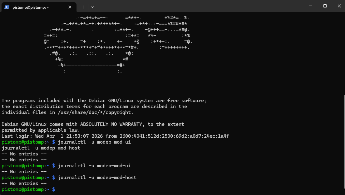

Check /var/modep/user-files. This is the folder in which the recordings should end up in.
Check the service logs to see if any warning or error gets logged:
journalctl -u modep-mod-ui
journalctl -u modep-mod-host
Hit the ‘end’ key to see the most recent log lines. ‘q’ to quit.
this is what comes up when i input those prompts. also nothing is going to my “user files” files in the modep browser site
Looks like you’re using pistomp, I just checked, the plugins do produce recordings on MODEP, under “Audio Recordings” folder.
