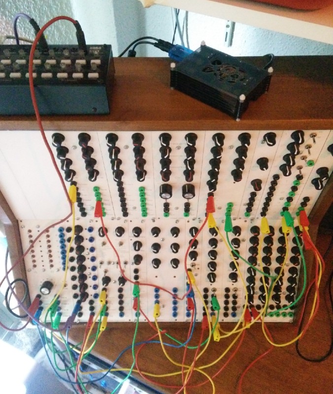

It seems support for RP4 is only mentioned in the sticky topic. Its quite significant i think.
Amazing addition to my imagination-station. Thanks for all the good work!
