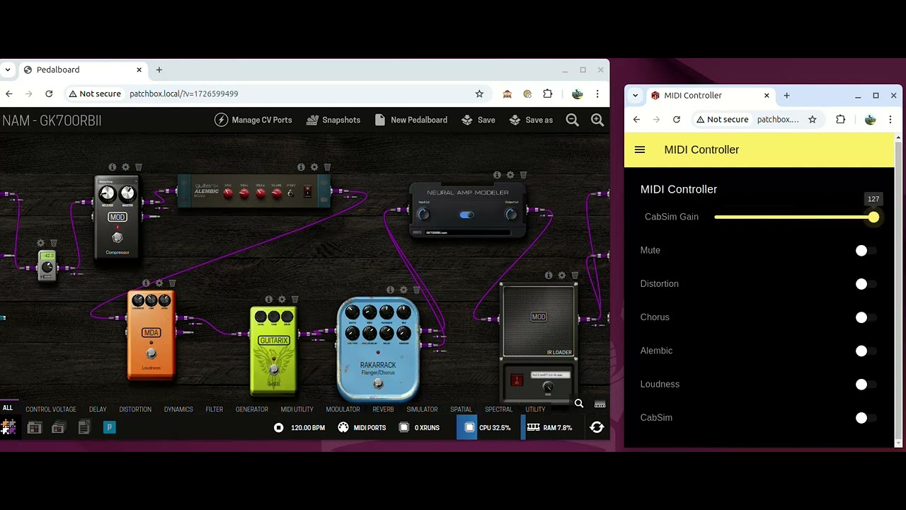

Hey all!
I’ve got a new release of the MODEP Node-red dashboard! This update adds the ability to define and use up to 7 midi controls to turn on/off plugin parameters or control a variable knob or control within a plugin. I also added (from a suggestion from @KAOSS) a CPU usage monitor in the system information.
There’s a new option called “MIDI Configuration” where you can define the MIDI value and label for 6 switches and 1 slider:
The “Get Config” button is useful if you restarted node-red and need to refresh the configuration that is stored in node-red.
Right now I’ve limited the controls to 7 as that seems to fit well on my phone. I could easily add more if that seems to be something that more people want. You can also do it yourself too in node-red. Simply input a value and label for each and click “Update”. Then switch to the “MIDI Controller” option:
You can then slide the slider for whatever control you attached that MIDI value to or click the switch. Note that this controller is “stateless” as it doesn’t know if the plugins that you’re using are “on” or “off” when this page loads. I typically use MIDI to turn on things that are, by default, turned off. Like Chorus, distortion, etc.
And yes, you can “assign” a MIDI value to a MODEP plugin parameter with this MIDI controller, just like a physical controller!
If you’ve already imported this dashboard then you’ll want to delete whatever you have and re-import the attached file.
MODEPDashboard_v2.zip (9.3 KB)
And here’s a short video of me adjusting the Gain on the Cabinet Simulator, turning on/off the cabinet simulator, muting the tiny gain and turning on/off the alembic preamp.
Just be aware that right now you can only have one set of values/labels for each control so you do have to plan out how to use MIDI to control MODEP. At some point I might add the ability to have multiple “mappings”.
