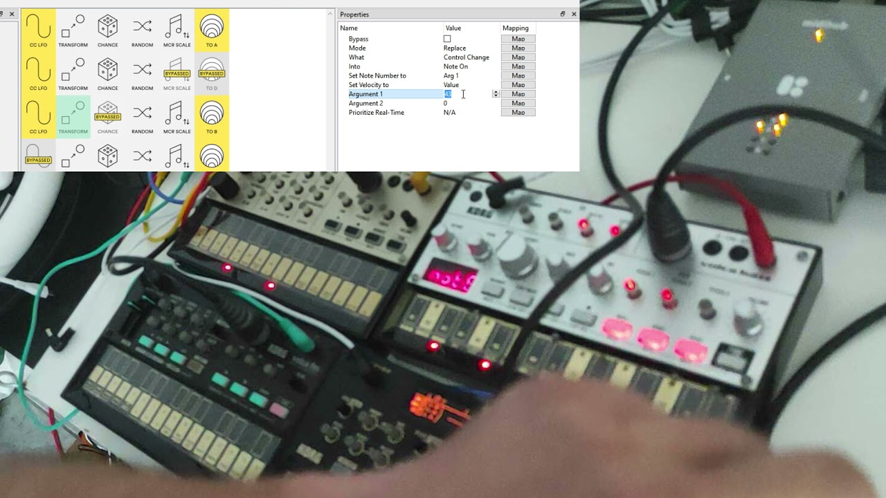

Thinking a bit more on this, maybe something like this could be made to work
LFO generating cc messages, a transform pipe to turn them into notes; a chance pipe to thin them out, and a scale remap pipe to make them more musical. I don’t have a chance to try this out just now, but I will do so when I get back in the studio.

I want to use the MIDIHub as my own sound / signaling device. As far as I have understood it so far you always need a MIDI signal from the outside to use MIDIhub. If we had a pipe that would generate MIDI signals, we could do incredible things, random sequences, arpeggios … it would be great.

So here we go. MIDIHub as standalone Instrument.
Even the Volca Drum is triggered by the MIDIhub
