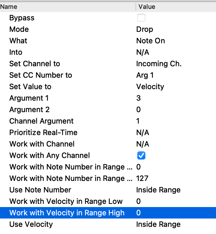

I have tried using a Limiter to block any note on below a certain velocity due to that second note on being 0 velocity but it doesn’t seem to change it. I suppose I could block the open string notes with a note filter but then it would cancel out those notes when fretted as well.
I am about to give up and just accept that’s how they built the thing which is a drag but thought I’d see if any midi hub experts might know how to fix this behavior. Thank you so much for your time and my apologies for the long winded post.

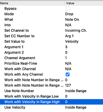

Hey @Nalma1, have you tried a Drop Transform…
…set to Work with Velocity 0?
Thank you so much for your reply. I gave it a shot and it did not solve the issue. I think what is going on is that it actually sends a note-off on the string that i am playing in order to keep “open” strings from ringing indefinitely. However midi-hub seems to pick it up as a note-on message.

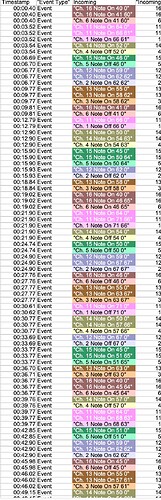

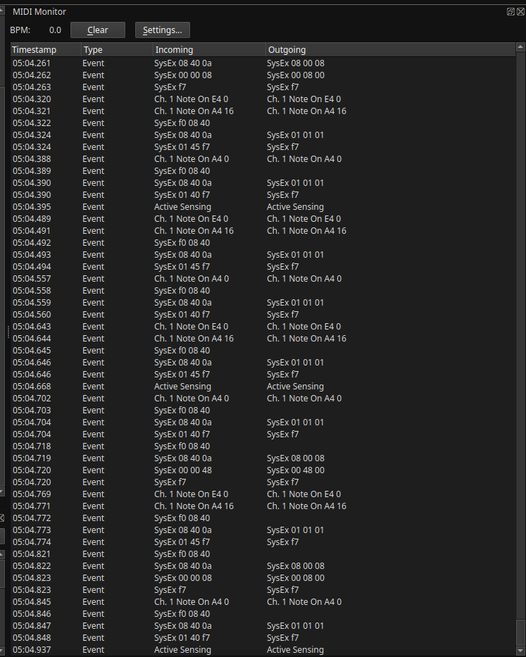

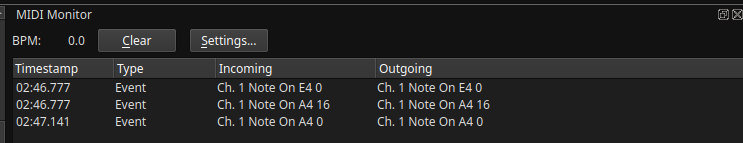

I just noticed the uploading instructions and will follow them but for now I took a couple screenshots. The first is an isolated example of the note on behavior. The second is the full list of events the mad catz mustang gives out. I have not found any of the other signals to be an issue. It really is just how the guitar is trying to mute open strings so it sends a note-on(off?) when any string is released.
It’s that first E4 0 Vel that is causing the issue I think. This happens on all the “strings” so if i played the 5th fret on the B String it would give me a B3 0 Vel signal before the E4 note that i am fretting if that makes sense. Thank you!
Mustangisolatednoteonbehavior.txt (1.6 KB)
MustangMidiEvents.txt (18.3 KB)

  1. The Mustang sends out the 0 vel “Note-On”, I quote because I think its supposed to be a note-off in order to stop an open string from ringing out indefinitely. So when you touch a fret it silences the open string. Other than that I dont know why it does it. Renoise interperets these as note-offs (See screenshot below). The 0 Velocity notes are the open strings that i am fretting.
  2. yes the guitar transmits on channels 1-6. 1 channel per string. I have used the channel remap in midihub to make it a single channel but it doesn’t really matter for my workflow whether its 1-6 or a single channel.
  3. I play it polyphonically. I do strum it sometimes but mostly pluck it fingerstyle. But this particular setting which is a mode where just pressing buttons triggers a note without plucking a string. Almost like a keyboard but in the form of a fretboard.
My apologies this is difficult to explain as it is a bit of a niche controller. It actually works pretty well when live recording but this problem mostly happens when I am using it to step sequence in renoise. It skips multiple lines due to the multiple note-on signals it sends.
Here is a screenshot of how Renoise interprets this behavior.

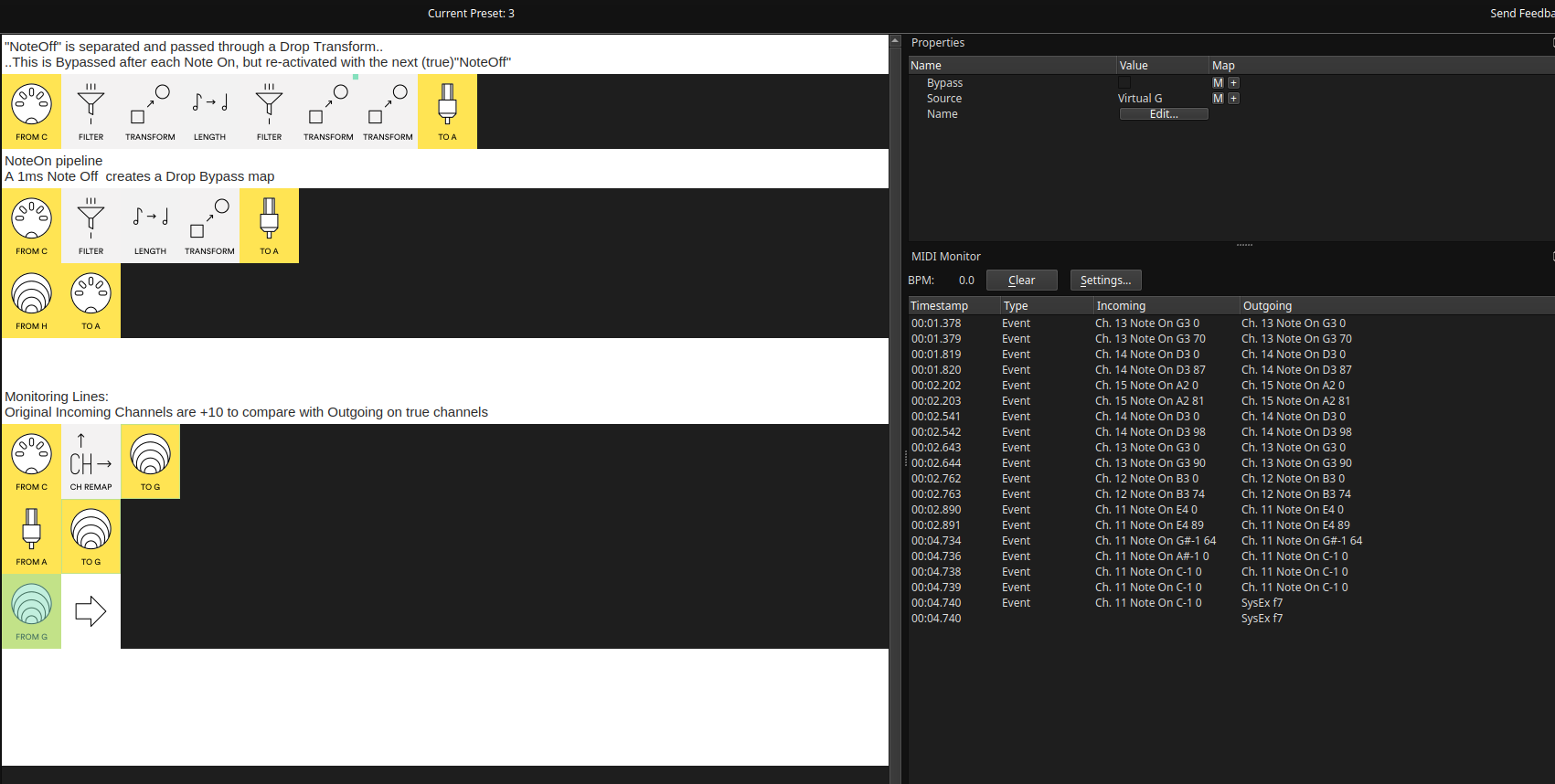

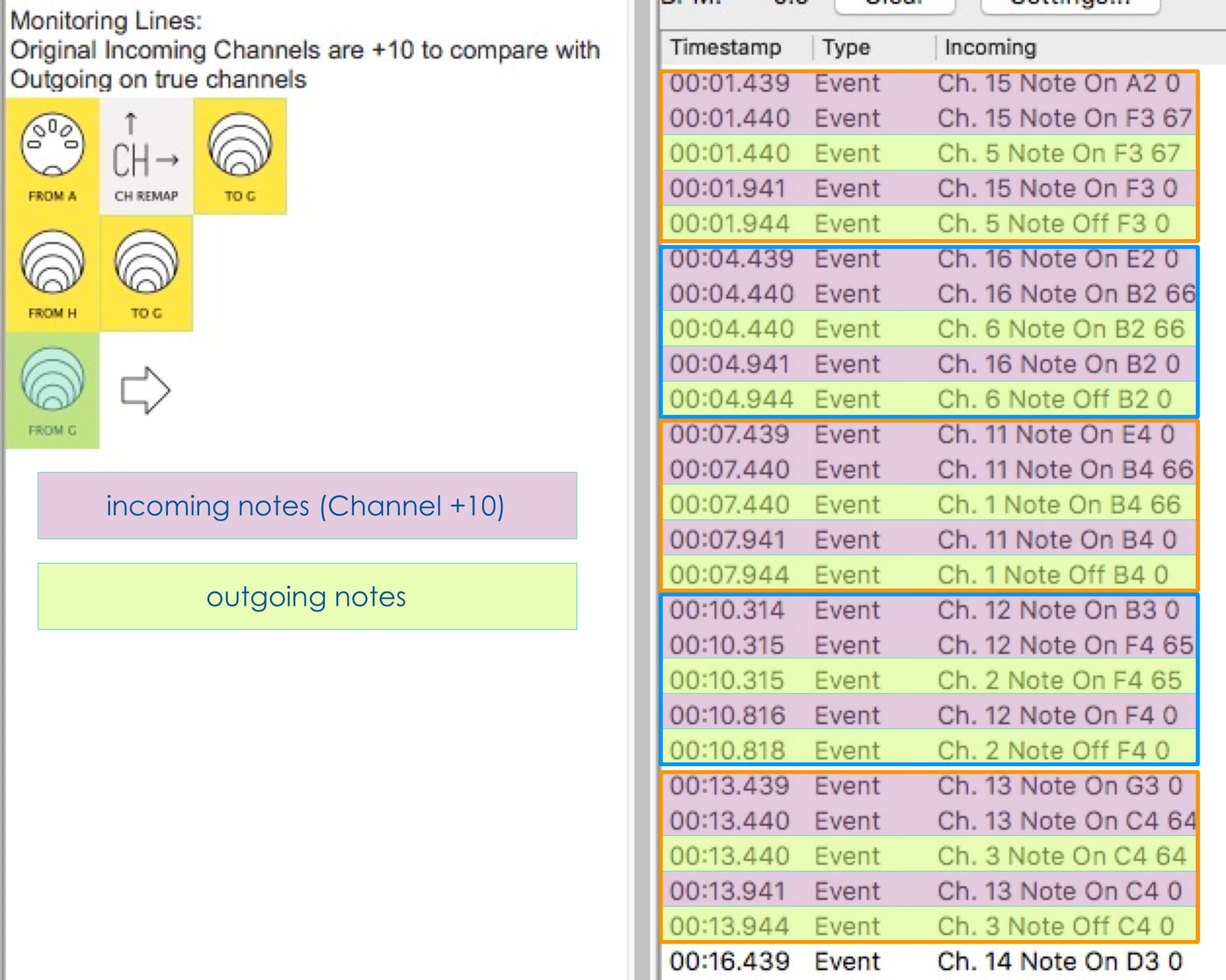

Just completed a first attempt at “Dropping Mustang Muting Pre-Notes”
Here’s an shot of a combined message flow:
where the original incoming notes are raised by 10 channels to distinguish from the true Outgoing notes…
I think we have the desired effect of losing the “pre-note” (which appears to occur 1ms before the “played note” [see 1])
This is achieved by using a Drop Transform that is “switched” Off and On by the “true” Note On & Note Off events, respectively:
Here is the preset:
Nalma1_Drop_Mustang_muting_notes(monophonic).mhp
Things to Note
  1. I set up a Mustang simulation to feed into this preset. This sends “pre-note” 1ms before the “true” Note On. The internal timings are based on this, so you may need to adjust the Length durations.
    (see also: the Outgoing “true Note Offs” are 2-3ms after the Incoming. This is an artifact of the Length pipe in pipeline 1)
  2. The preset relies on two mappings going to virtual H (chosen because most users don’t!)
    If you are already using virtual H, you may need to make changes.
  3. This preset is very much monophonic. It will break with overlapping notes. There are two ways to use this preset with other, polyphonic, play; the simpler strategy would involve more knowledge of what controls are on hand to tell MH to “switch mode” from “sequence” to “normal play”
  4. The Monitoring section is just for that. Once everything is checked and hunky-dory it can be deleted.
hope it works!

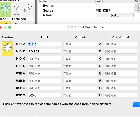

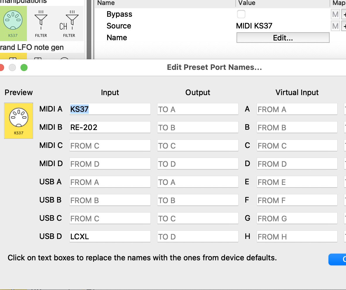

Hey I am really appreciative of this, However I am not totally sure how to adapt this to my system. Do I just change the In’s and Outs to the appropriate ones on my system? I will experiment with it to see if I can get it working. Thank you!
Yes
use File → Append From File...
If you get stuck post, your current preset.
(It would then be useful if you would Edit the Preset Port Names to make clear what the In’s and Outs are)
