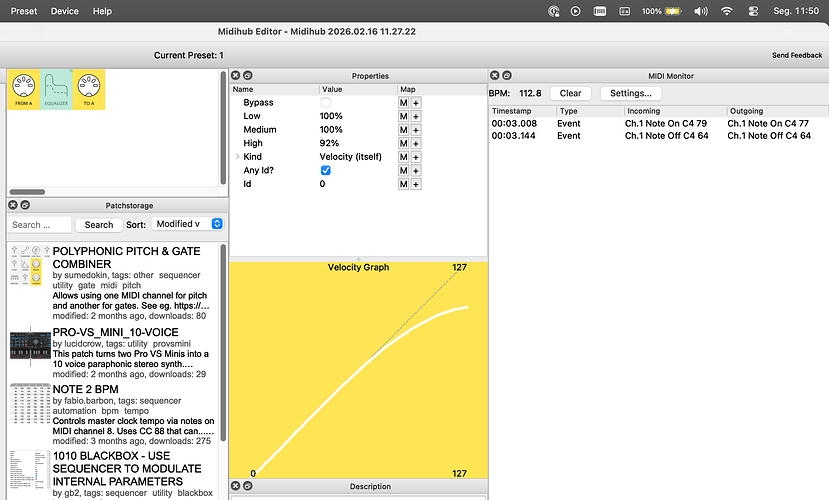

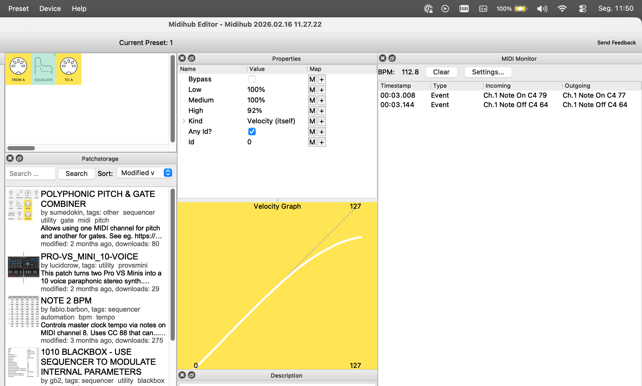

Would you kindly help me? Why does the output velocity note not decrease with the velocity curve? Both incoming and outgoing C4 64 are displayed in the sample below.

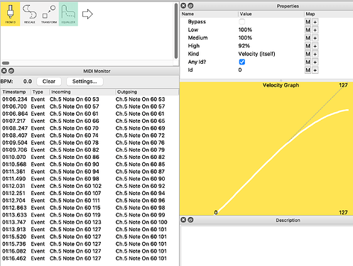

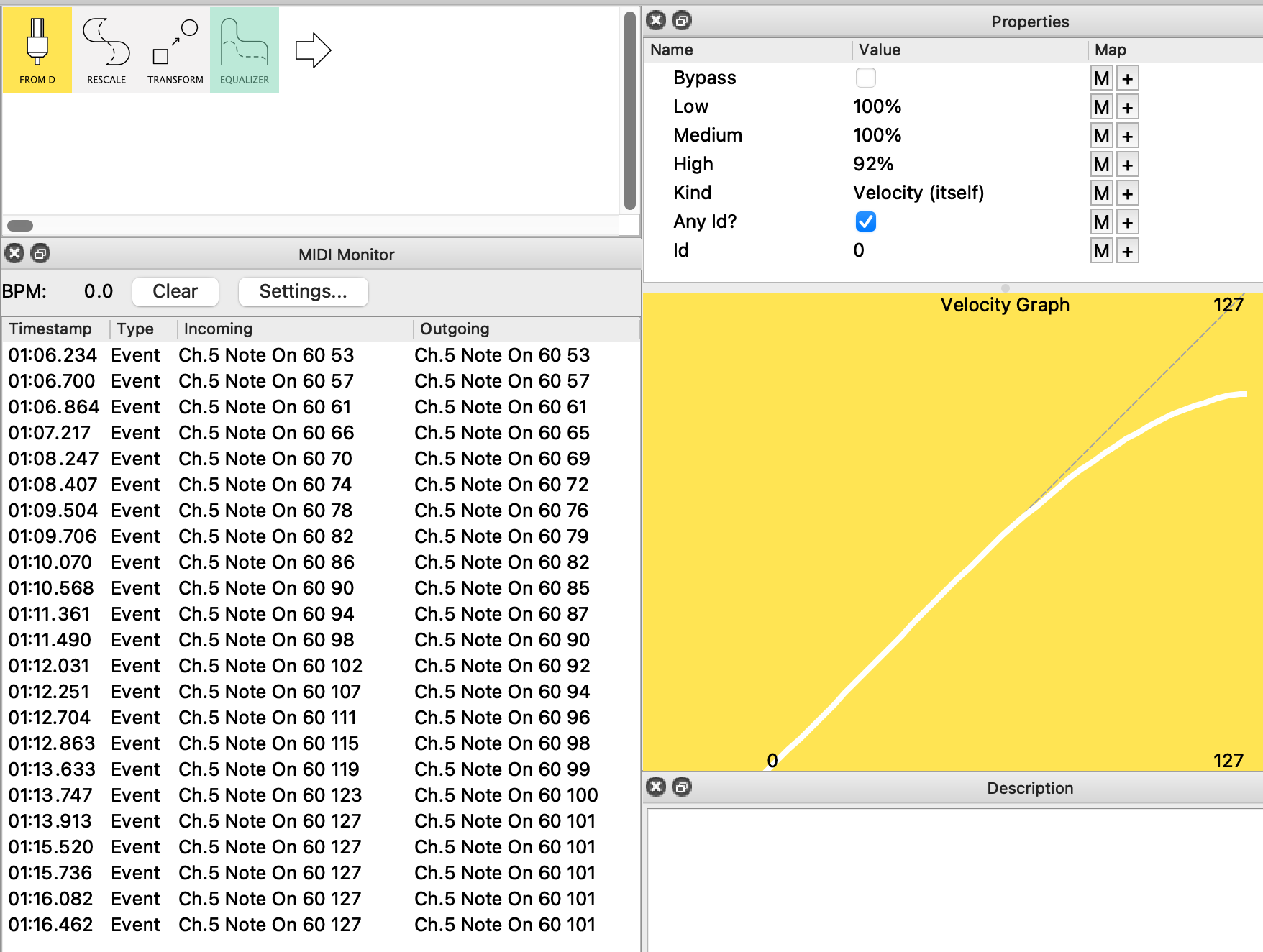

The settings you’ve chosen for the “Velocity (itself)” curve leave the lower velocities unchanged.
with L100%, M100%, H92% the velocities only start to differ when incoming velocity exceeds 65:
the graph gives an idea of the outcome from the interplay between the 3 values.
(I have to confess I don’t understand how EQ works under the hood, so I tend to just play around until I get the shape I want!)
C4 64 line is the Note Off event. Equalizer does not do anything to Note Off events. You can see the Note On velocity does get changed.
I’m not sure if there’s any modern keyboard available that would make use of Note Off velocity and any sound generator that would take this param into account. I would love to see some examples though. :slight_smile:
Thank you so much for your help.
In fact, the input notes’ velocities were significantly lower than the curve’s attenuation point.
