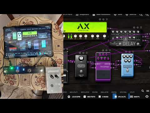

I can’t switch between them
It’s my sound test of Pi Sound and Modep
