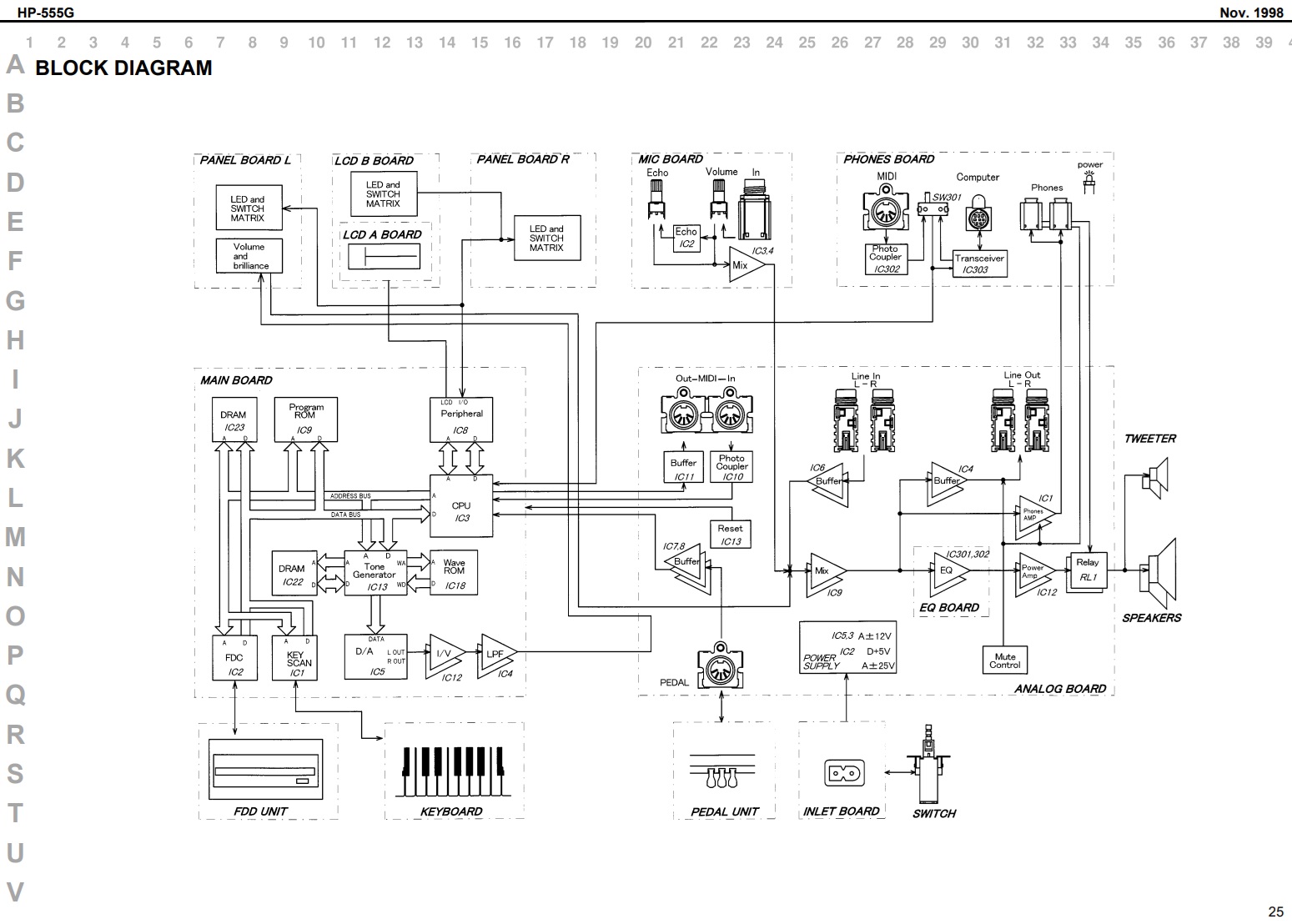

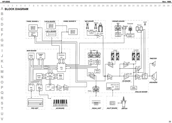

A common failure for electronics from 2010’s is leaky capacitors. (Something todo with switching production from Japan to China)
This is from the service manual from an older model Roland HP electric piano:
It pre-dates USB, but it’s my best guess at roughly what’s inside the electronics of the HP503.
There is a circuit path via IC13 (Tone Generator) → IC5 (‘Data’) → Panel L (Volume and brilliance) → IC9 (Mix) which has dozens of capacitors as potential points of failure, independent of the midi Out and Mic board.
So that is my working theory. Bypass the internal Tone Generator path.
