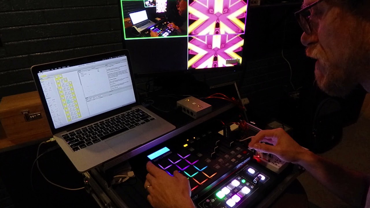

I figure I should post here also a bit about my usage, because I am not producing or modifying sound with this device!
