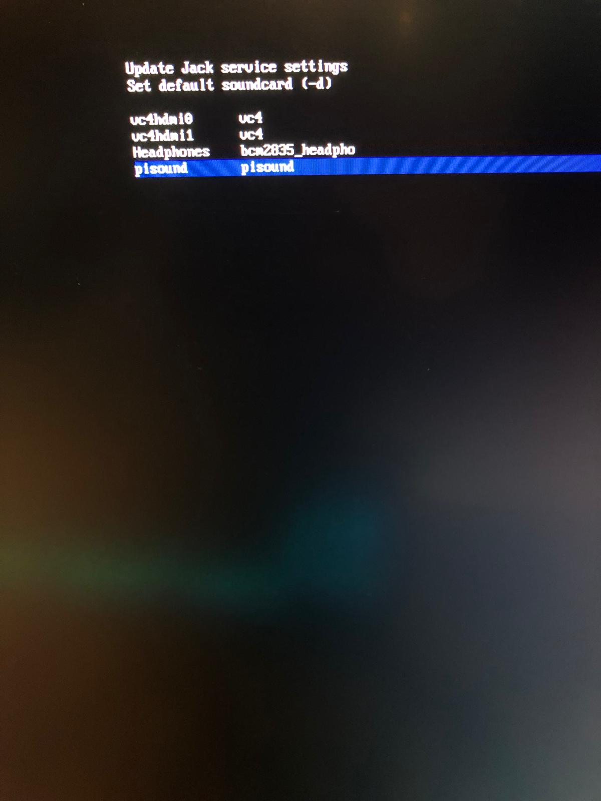

Thanks for the suggestion Giedrius. I went to the whole process again (burning the sdcard with PatchOS and running the wizard for the first time)
I selected Pisound in the wizard (I uploaded an image for confirmation)

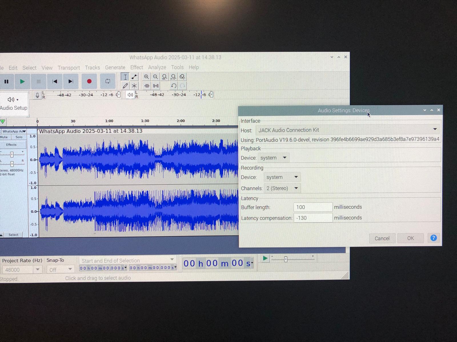

BUT Audacity and Pianoteq (at least) work well. I uploaded an image of Audacity’s Audio setup Window
