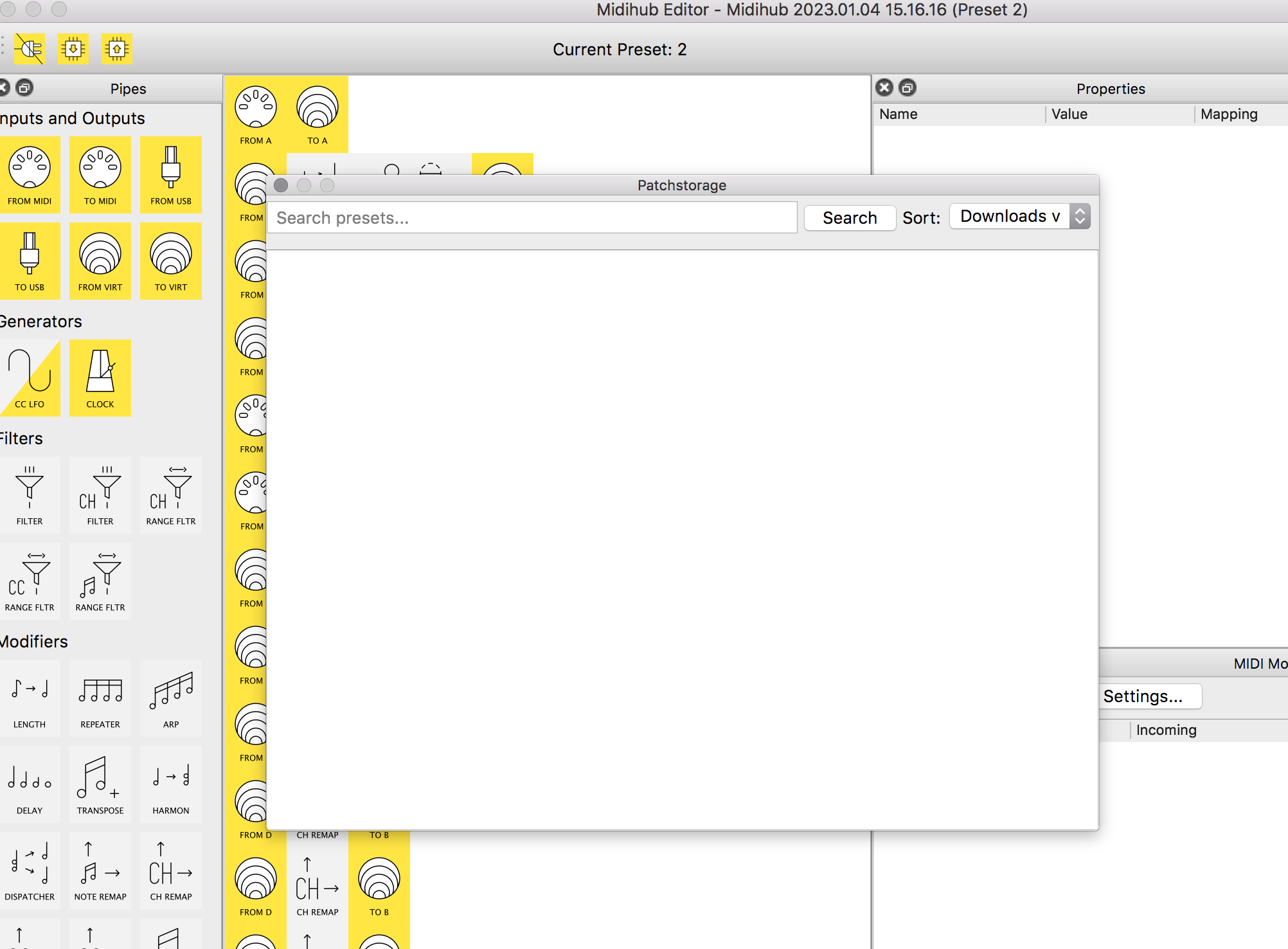

Could you post a screenshot of the Midihub Editor with Patchstorage pane open?

don’t usually keep that pane open, but when I select it it the View menu,
FYI, I get this:
Screen Shot 2023-01-04 at 14.58.52
for a few seconds, then it loads up.
Is yours just blank all the time?
I get the same Loading message briefly, then it goes blank. This happens when opening the pane, as well as when running a search.
