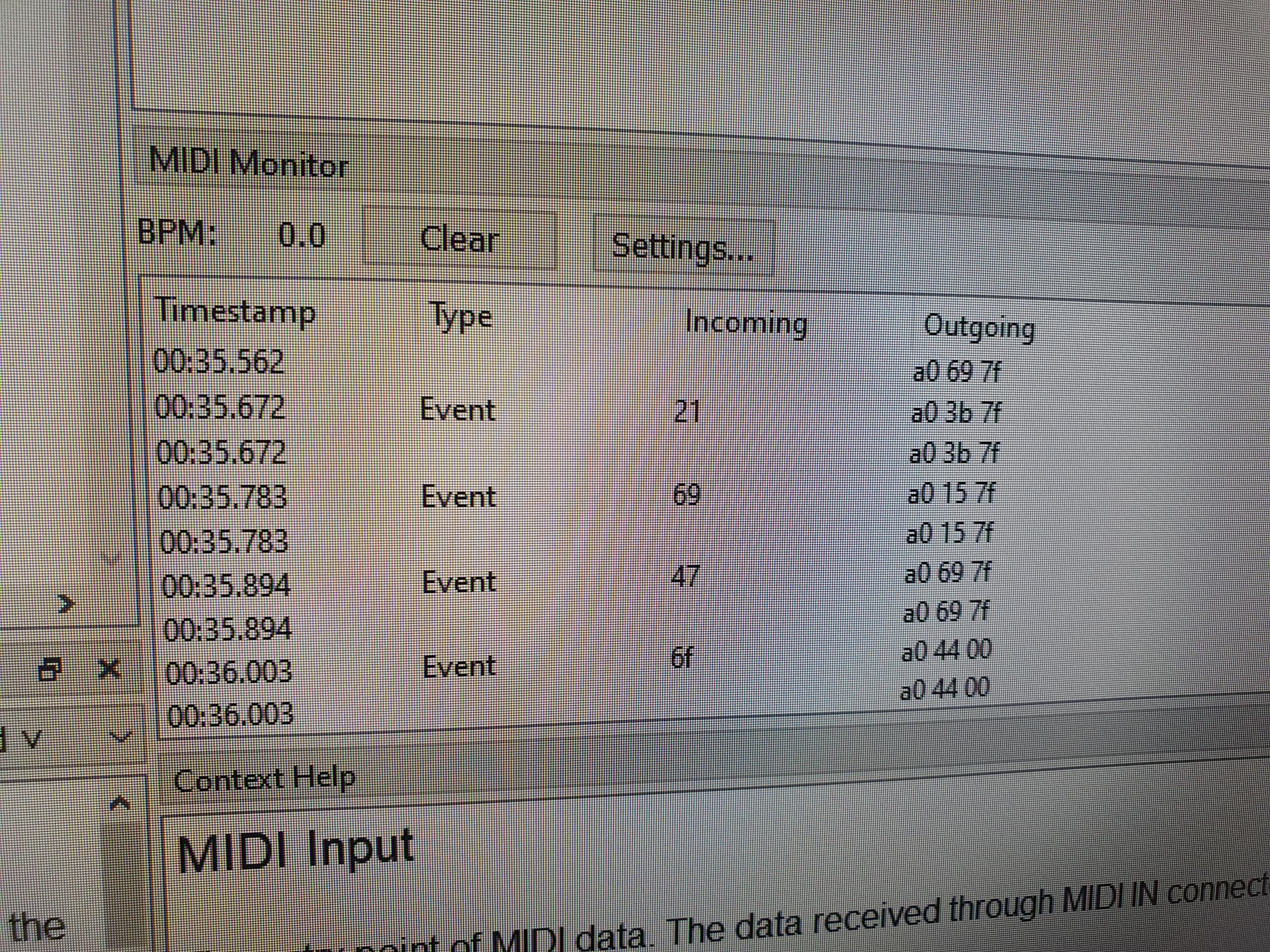

the problem is that ak5 overflow the midihub by sending too much midi after touch message in a short time

hey,@ahgi not sure what your screenshot is for: (I can see you’ve got the Settings on Raw Display and that you’ve got a bunch of Chan 1 Polyphonic Aftertouch going out - don’t understand why they’re all duplicated! @Giedrius?)

In the image you can see how often are the midi messages

OK, I see.
Doesn’t look that busy to me, but @Giedrius will know better…
To make a sense of this, @ahgi, we need all the information at once - the preset file (.mhp) you’re using at the moment, the description of what’s being inputted, the MIDI Monitor exported into a .csv file, and it’d be great to receive a MIDI clip stored in a MIDI file (.mid), you could simply record your synth’s playback in a DAW and then export it to a MIDI clip, there’s many ways how to do it. Then we could use the MIDI clip ourselves to reproduce the exact same input you provide to Midihub and see what’s going on exactly.
From the screenshot you provided, there does not seem to be that many events, we need more information to get a better understanding of the situation.

i am using this set up & i filtered the unnecessary signal from the keyboard

The video does not really add any new information about your setup, we still don’t know how your preset looks like, nor what is the actual input that goes through Midihub that causes overflow messages to occur, and indeed, even if you see them in the monitor, it does not mean that the messages are not getting processed, as monitoring has the lowest priority, so as to not interfere with the important MIDI processing.
