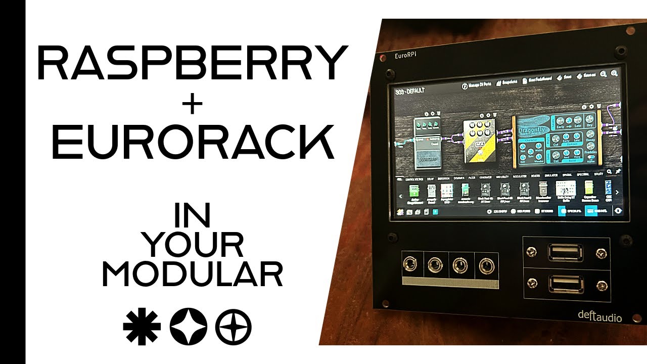

I have built a EuroRPI Eurorack module and installed Patchbox on it and MODEP. Everything is running correctly.
I would like the Browser (Chromium, on a Raspberry) to auomatically start at boot/login and display my pedalboards. In “KIOSK” mode, if possible…
I had a look around on the net and tried “autostart” and “cron tasks” but they didn’y work.
Is there any guide or any suggestion to make it work?
Here’s a video of my build:
