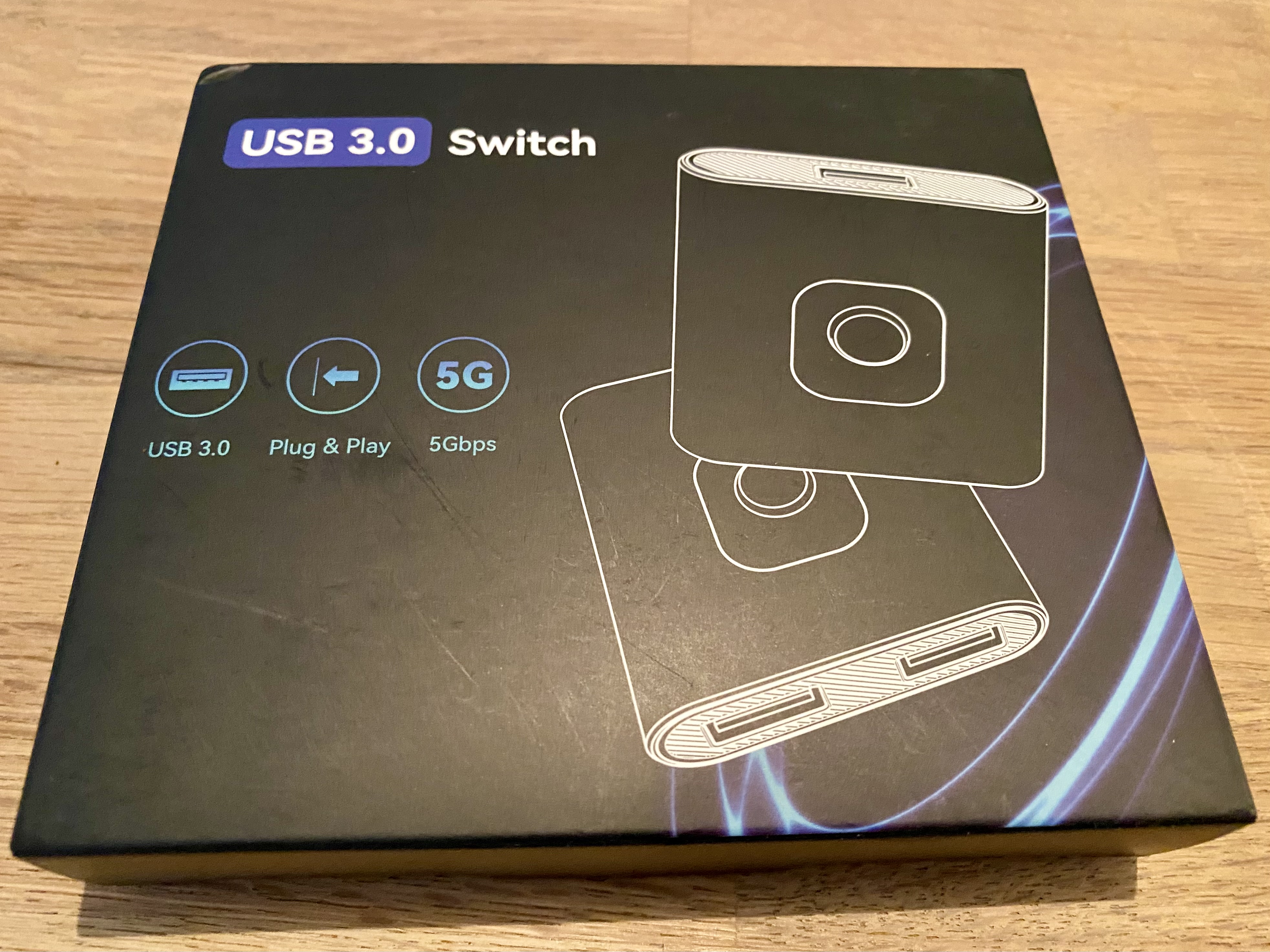

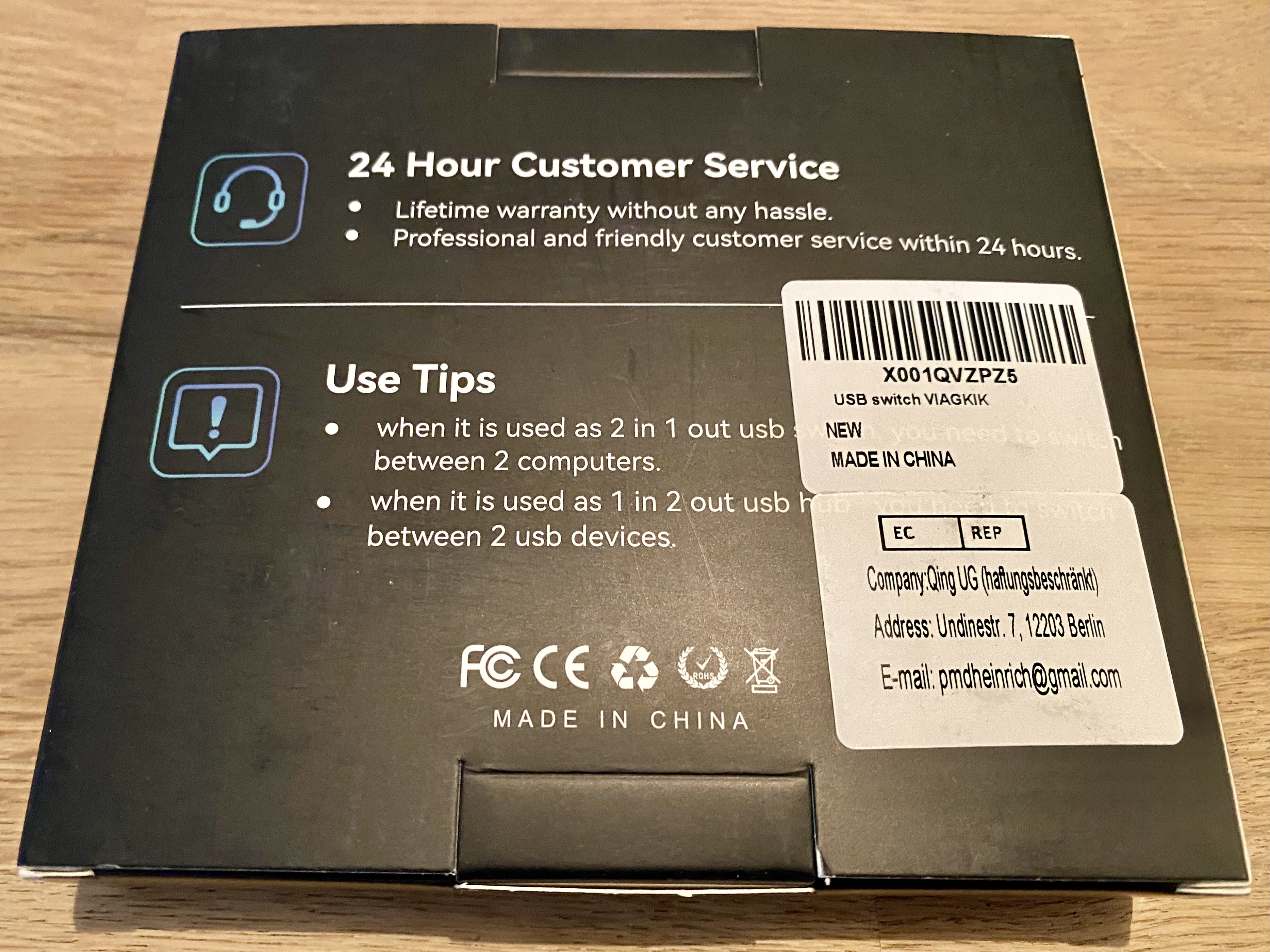

Bi-directional USB 3.0 switch
In search for a more workable solution I’ve added a USB switch between the Midihub and the A4C connection. In my case I’ve bought the ViagKiki Bi-directional USB 3.0 Switcher on Amazon. The second output of the switch is connected to a port on my Macbook. A second port on my Macbook is connected to USB-C host 1 port of the A4C. That way I can switch between my DAW-less setup, with all devices connected to the Overhub / A4C, and a ‘configuration setup’ with the Midihub running directly to the Macbook. As the A4C remains connected to the Macbook too, it is still seen by the Au4X software.
Midihub and testing configurations
The Midihub is shown as (temporarily) ‘not connected’ when in the fore-mentioned ‘configuration setup’, but it immediately shows up as ‘connected’ when switching back. In the ‘configuration setup’ its not possible to play devices connected to Virtual USB ports of the Midihub, because everything connected to the Overhub is temporarily ‘not connected’. But to me this workaround is the most workable and reliable solution for switching modes. Not only for DAW-less, but every situation in which the Midihub is connected to a MIDI host like the ones from iConnectivity.
In the Midihub editor I can configure a ‘dry’ test connections using the MIDI monitor. After storing a configuration I virtually disconnect the Midihub from the editor, then I return to DAW-less by hitting the digital button on the USB Switcher.
