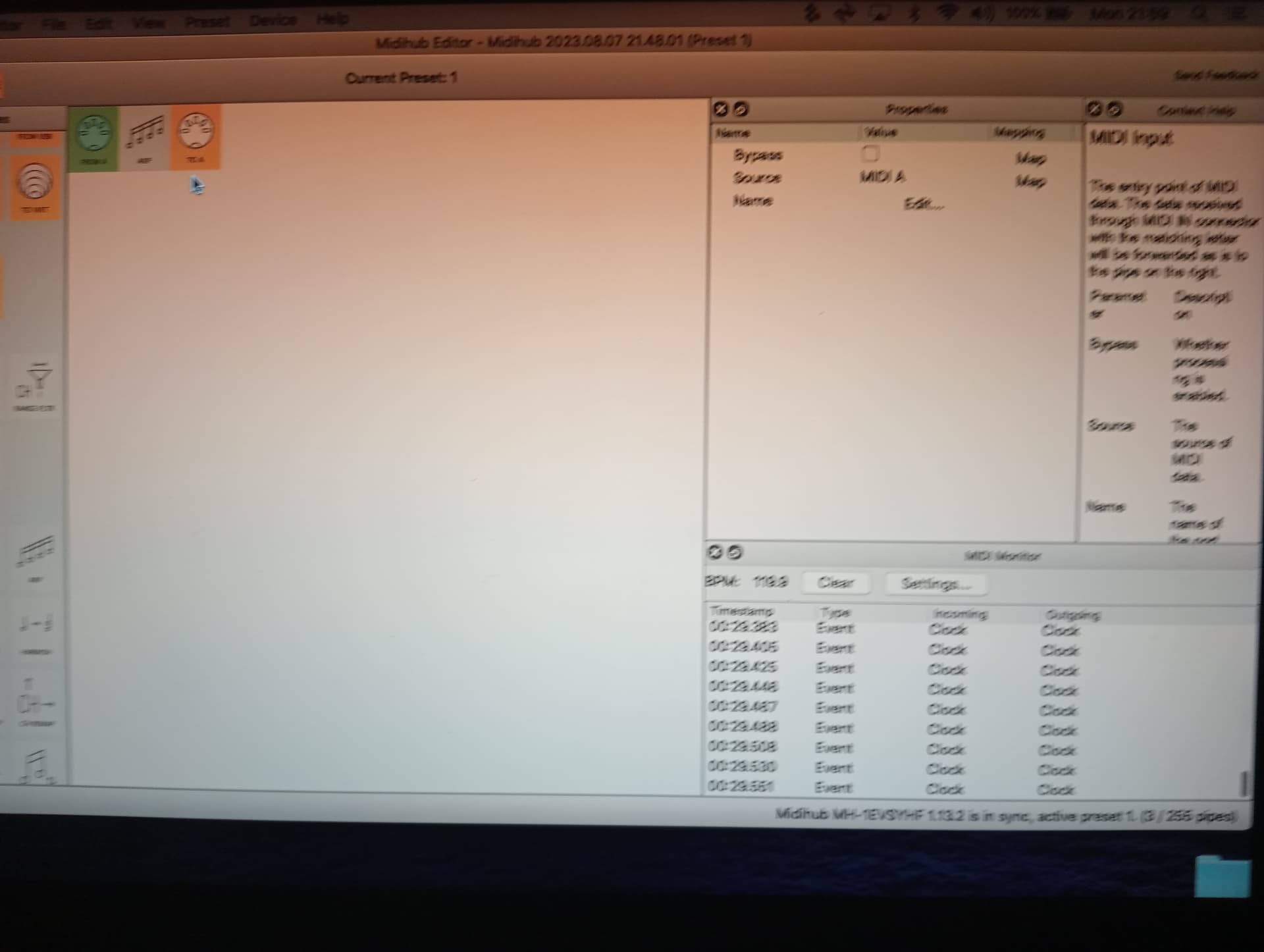

Hey, Brian
I see Clock in your MIDI Monitor but no Note messages.
Could it be that your sequence is going out the other MPC port?
Don’t know what “time division being altered” means

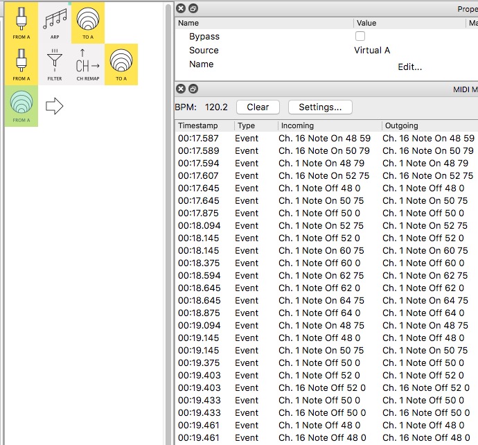

When monitoring a working ARP, be aware there’s a slightly confusing foible:
Note here, monitoring ARP pipe…
Screen Shot 2023-08-08 at 09.08.06
…there’s only Timed Note Ons coming out
but monitoring the next pipe…
Screen Shot 2023-08-08 at 09.11.38
…we see the output as it really is.
Note: I’ve changed my Monitor Settings so that I’m not seeing Clock
Screen Shot 2023-08-08 at 09.37.34
I find it useful to have a (temporary) extra Monitoring line
ARPwithExtraMonitorLine.mhp (393 Bytes)
which sends a ‘re-channeled’ copy of the input for comparison:
Now we can see the input notes (remapped to 16) alongside our ARP line notes.
PS. On a Mac, doing shift-cmd-4 will give you a draggable cross-hair to make a screenshot of a selection of your screen.

Arp and Repeater require MIDI Clock (sync) messages to be going through them, in order to produce output. Does the MPC send the clock to Midihub?
Thanks…yes midihub is receiving clock from MPC
Can you show how the Monitor pane looks like while the Arp or Repeater pipe is selected?
