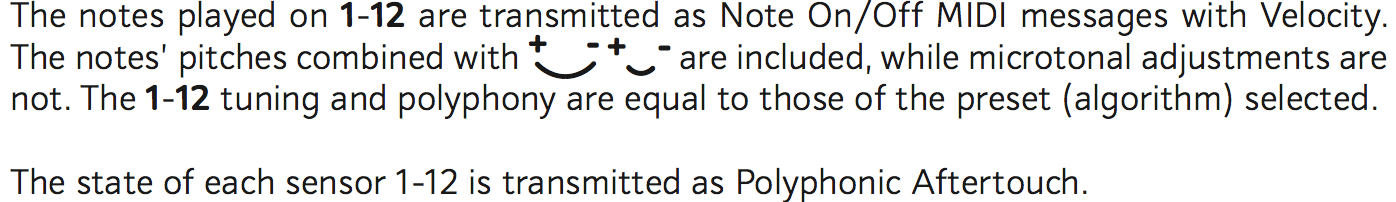

I’m intrigued to know what
looks like when received as MIDI messages…
EDIT
…yep, this might limit what harmonic co-ordination you can achieve.
detail
Having watched a few mins on Terra basic ops for tuning, functionality will depend not only on what Terra sends out but also what your other devices can handle.
In short, lots of scope with standard chromatic stuff but each device may be limited in terms of number of channels of pitchbend it can handle (at 1st glance, Maschine and Torso look like best bets for micro-tonal but I own none of these boxes).
Midihub can do Microtone with up to 16 channels but not on the fly (you can select one of 8 assignable presets via MIDI mapping, but now we’re going pretty deep)
