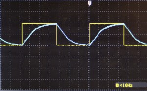

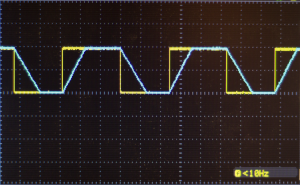

I had the Befaco slew limiter in mind tbh. So that would be slew rate when the values are going up, slew rate when the values are going down and a value which gradually changes the response from exponential to linear. If it’s not too technical of a reason, can you give a short comment on why current capabilities would not allow for such a pipe?
thanks for the Befaco mention; the oscilloscope shots from the site are useful in envisaging the basics of a pipe design:
(though many questions come to mind!) :smiley:

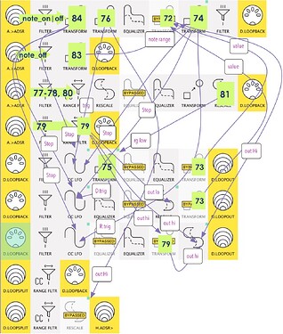

Rolling your own
So when I say …
“(Also not at all easy to emulate with current capabilities, IMO)”
…I’m not referring to a future native pipe, only to the processes one has to include to make a reliable generalised version with existing pipes.
I say this as a result of experience gained when creating an ADSR emulation…
...which involved a lot of interconnections
This is more complex than a slew but even an AR curve has some subtleties (see this discussion)
In short, @vorsakn, if you want to make your own version and you know the sort of rise-fall times you’ll be limited to, Yep that’s all do-able. Lemme know if my work on the AR curve experiments might be useful.
