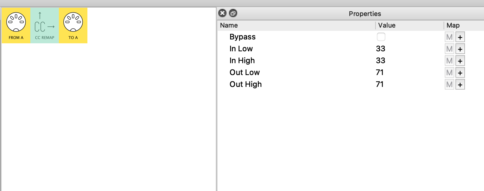

Thank you so much !
I used your method and it worked !
Then I also discovered that a simple CC remap also worked !!
Thanks a lot, it helped !!
Good.
As you’ve seen, CC Remap is slightly simpler.
Be aware, though, that it means that you would need a pipeline for every range of CCs mapped:
(from this entry on Transform Ranges)
