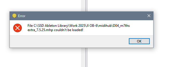

Error: Project couldn't be loaded!
While working on my project, I noticed some strange behavior — certain pipelines disappeared or were displaced without any action on my part. It felt almost like the effect of a virus or some form of corruption. To be on the
D04_m7ths extra_7.5.25.mhp (2.6 KB)
safe side, I saved the project immediately. However, when I tried to reopen it later, it failed to open entirely. Unfortunately, I’ve now lost access to the project completely.
Attached the corrupted project. I’m running th latest Editor update.
Why would this happen??
This is a significant issue, and I’d appreciate any help in recovering the project or identifying what might have caused this.

thanks for getting back. Yes, they stop making sense the moment the editor started to malfunction. Some pipelines got changed into others and displaced automatically. No, I didn’t have a backup of the very project I was working on. It happened while working, so even before I could make a backup or store it. It happened several times before, only now I thought I should flag.
I am not sure what actions I was doing specifically, other than changing some parameters on an LFO via laptop keyboard. There were some mapped pipelines in the same row I was working on, yes.
Is there any way to open the project after getting the error message? Or is it lost for good?
