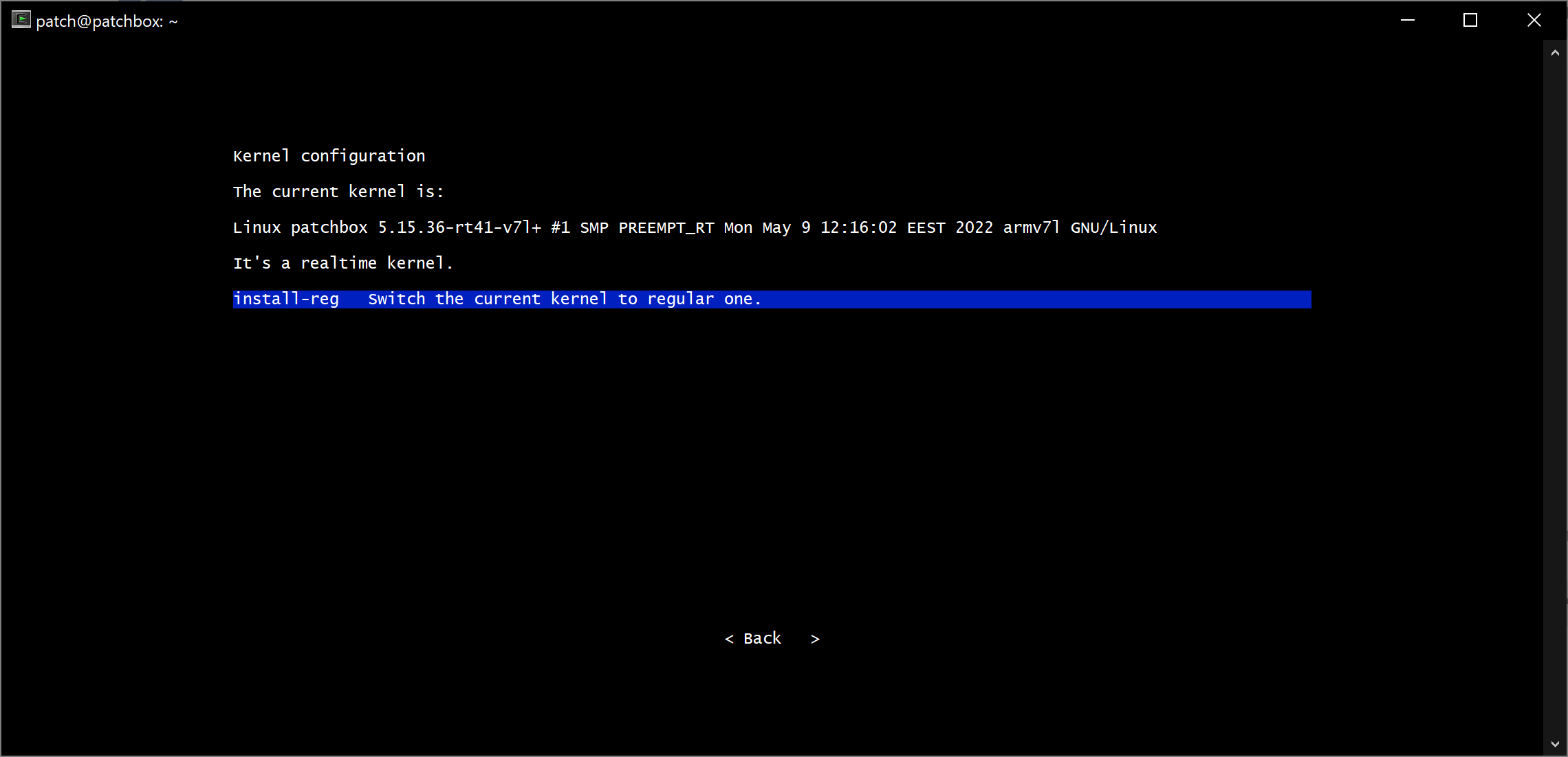

What version is displayed? I see this:

Try renaming kernel8.img:
sudo mv /boot/kernel8.img /boot/kernel8.img.bak
And then try reinstalling again:
sudo apt install --reinstall raspberrypi-kernel-rt
It worked, now it says real-time kernel. Thanks!
