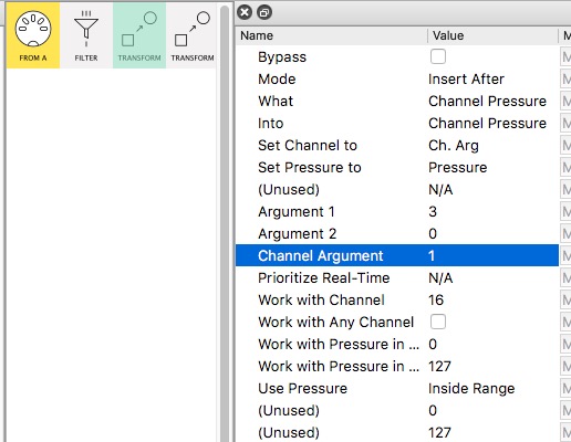

The simplest way to get what you want would be series of Transform pipes that look like this:
Screen Shot 2024-12-11 at 22.52.56
This only Transforms Pressure messages received on ch16. This particular pipe creates a new Pressure message on Ch1
