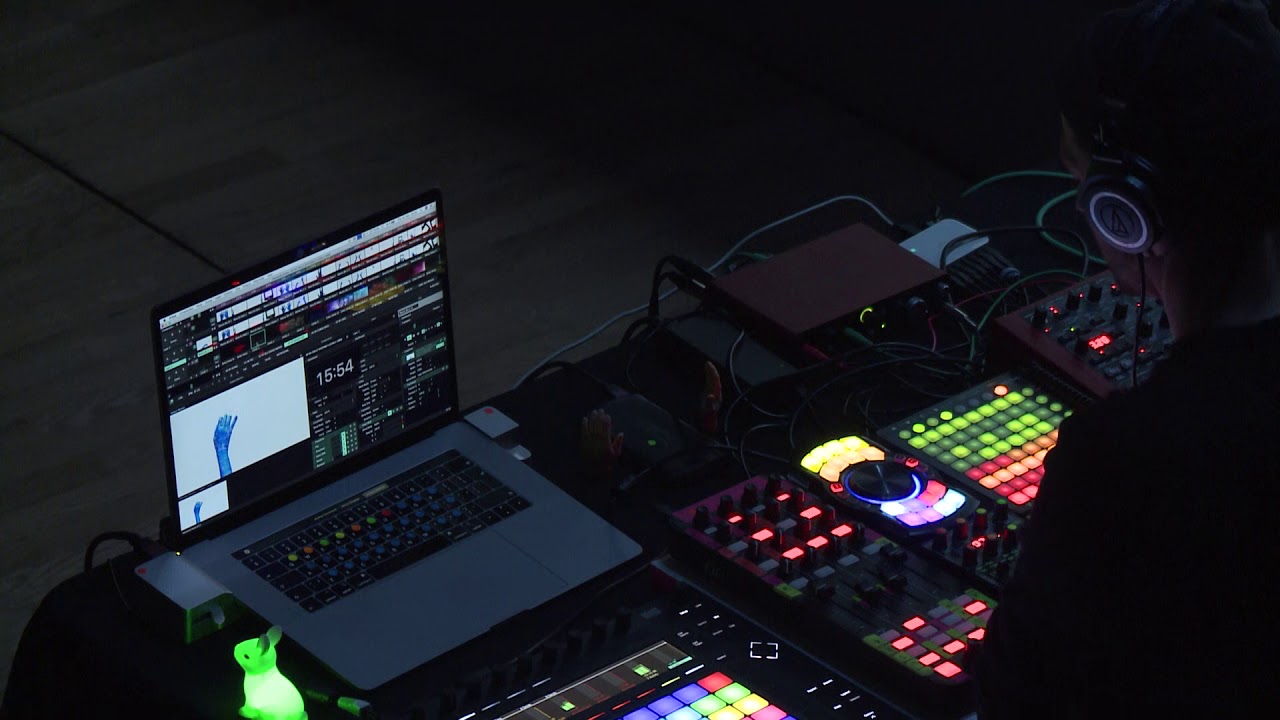

Meanwhile, I can share an early stage of it, before Midihub -and before few more hardwares that now are included-, to have an idea of what I’m intending to develope. It’s an audiovisual system based on the relations between hundreds of audio and video parameters, making it a quite complex real time audiovisual multi-instrument.
Here’s a link to a performance in New York at the Folly Systems festival 2019.
Thanks and cheers!
