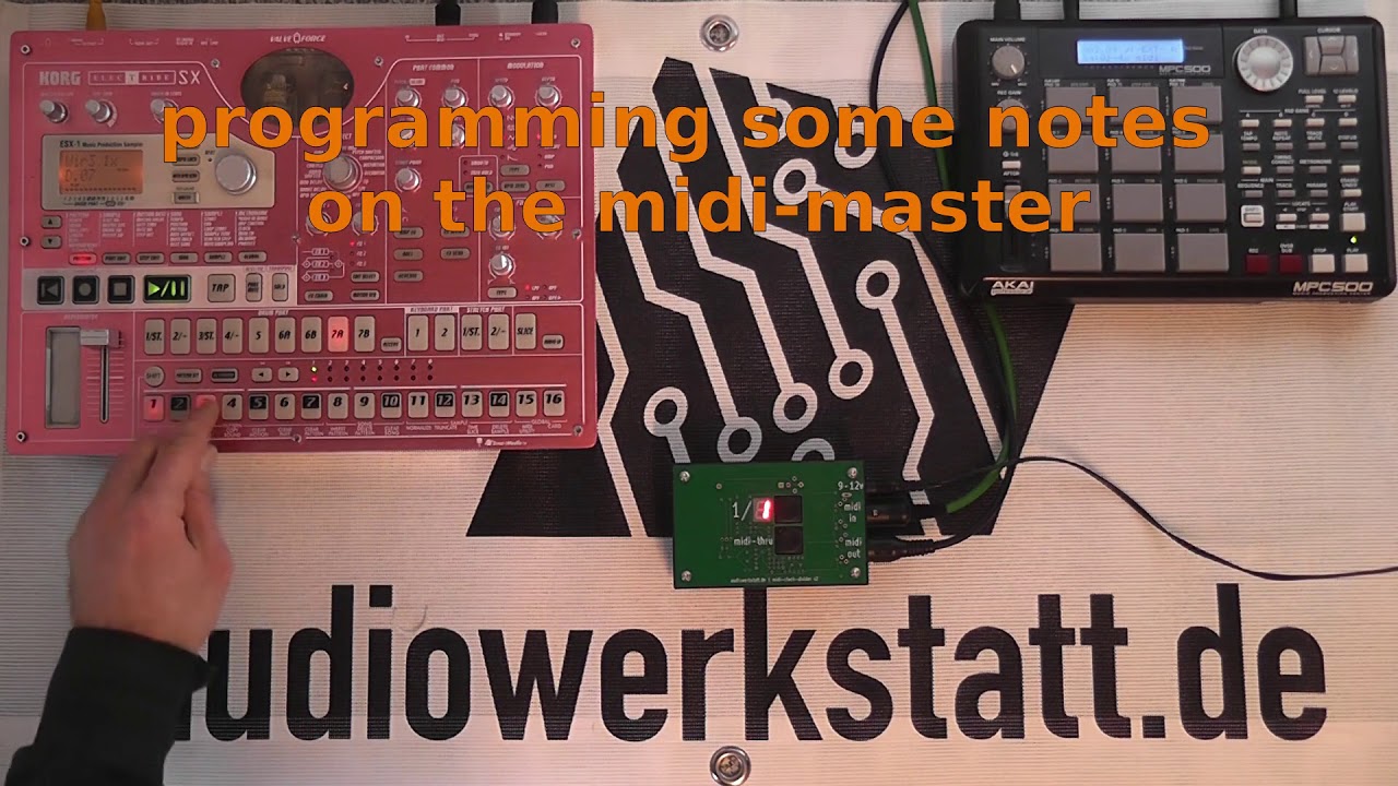

divider/multiplier functionality would make it such a banger.
examples:
of course, these devices are the option, but: each costs about the same as blokas and provides only one modified output. on top of that, multiplier and divider are two different devices. having a bunch of them would cost a grand easily. and – they are ugly, not controllable externally. high hopes blokas will support such functionality.
