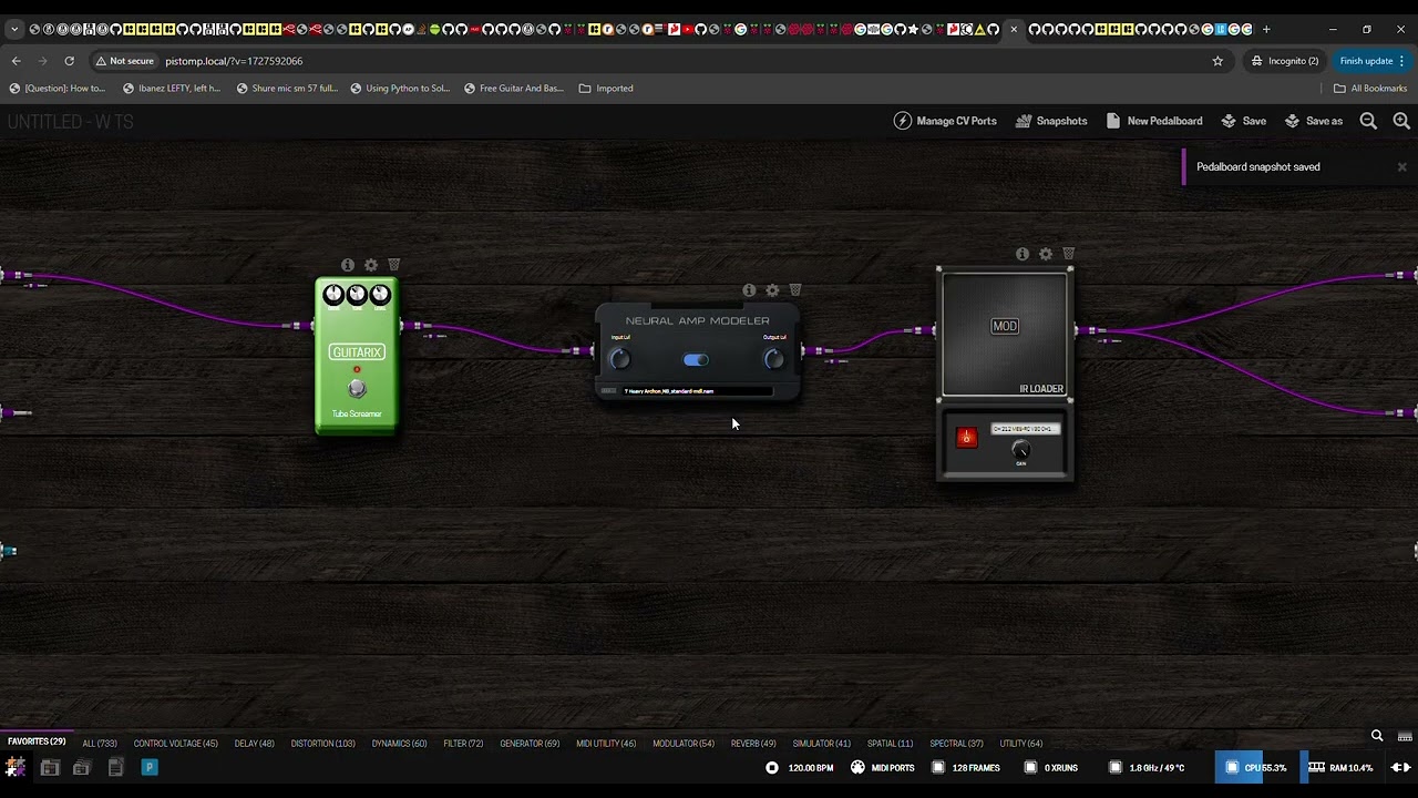

Here’s a little demo showing the creation of a pedalboard and creating snapshots for it. As you can see, the TS is being switched on and off when the snapshot is changed.
Oh, I was doing it wrong :no_mouth:
Sorry for bothering you, I usually this kind of explanations in documentation or tutorials, but this is the first time I see it used in action. Thank you and cheers!
