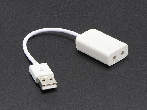

Alternatively, until I’m able to afford a pisound, could I use this to try running audio through it? Very cheap but provides a line level input to the pi:

As for the USB audio adapter, I think it might work, you may reconfigure the audio card following this guide.
