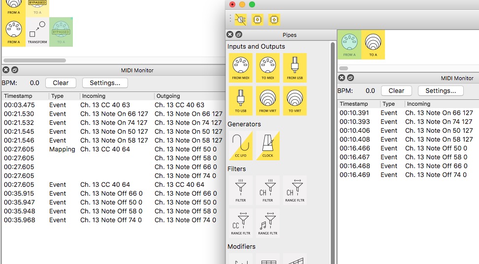

Hey, @GurtTractor
I guess @Giedrius will give you a better answer soon, but had to check this out for myself:

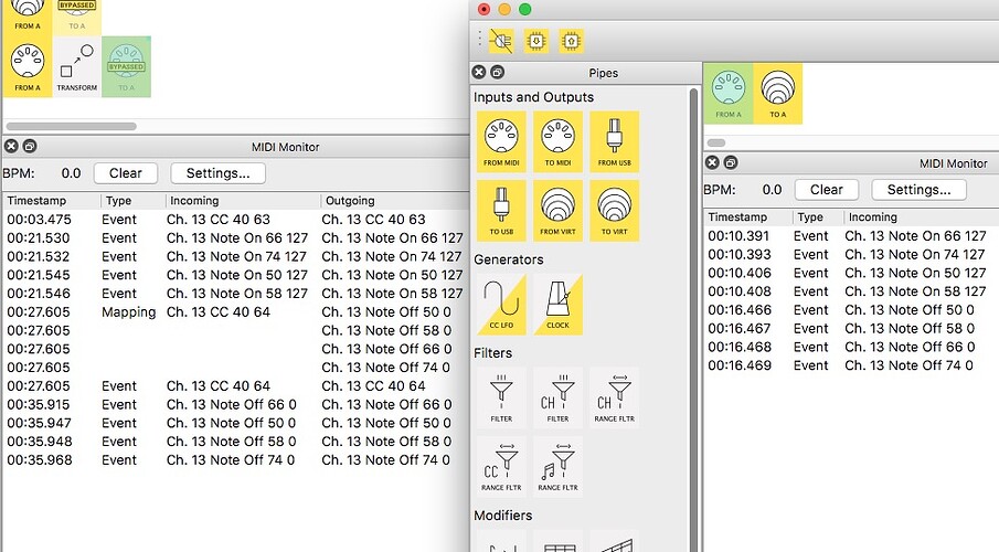

Here’s two Midihubs connected…
…we see 4 notes held while I disable MIDI-A_OUT with ch13.CC40 after about 6 secs.
Note Offs are created at that instant for each note (and then appear in Midihub2)
(just noticed they are created by “Mapping” CC40 and the “Event” CC40 appears after the Note Offs )
The extra Note Offs in Midihub1 are me releasing the held notes.
So my deduction is that MH is selective about sending Note Offs and doesn’t just send CC123.
I guess this makes sense when we consider multiple ports out but now I want to find out how many notes it will remember (cue Harmonise → Note Remap to octaves → Harmonise!):smile:
EDIT: just did Harmonise → Note Remap → Harmonise: It happily handled 81 = (9 x9) notes.
Tomorrow might try Harmonise → Note# to Channel Transform → … to get 729 notes…
