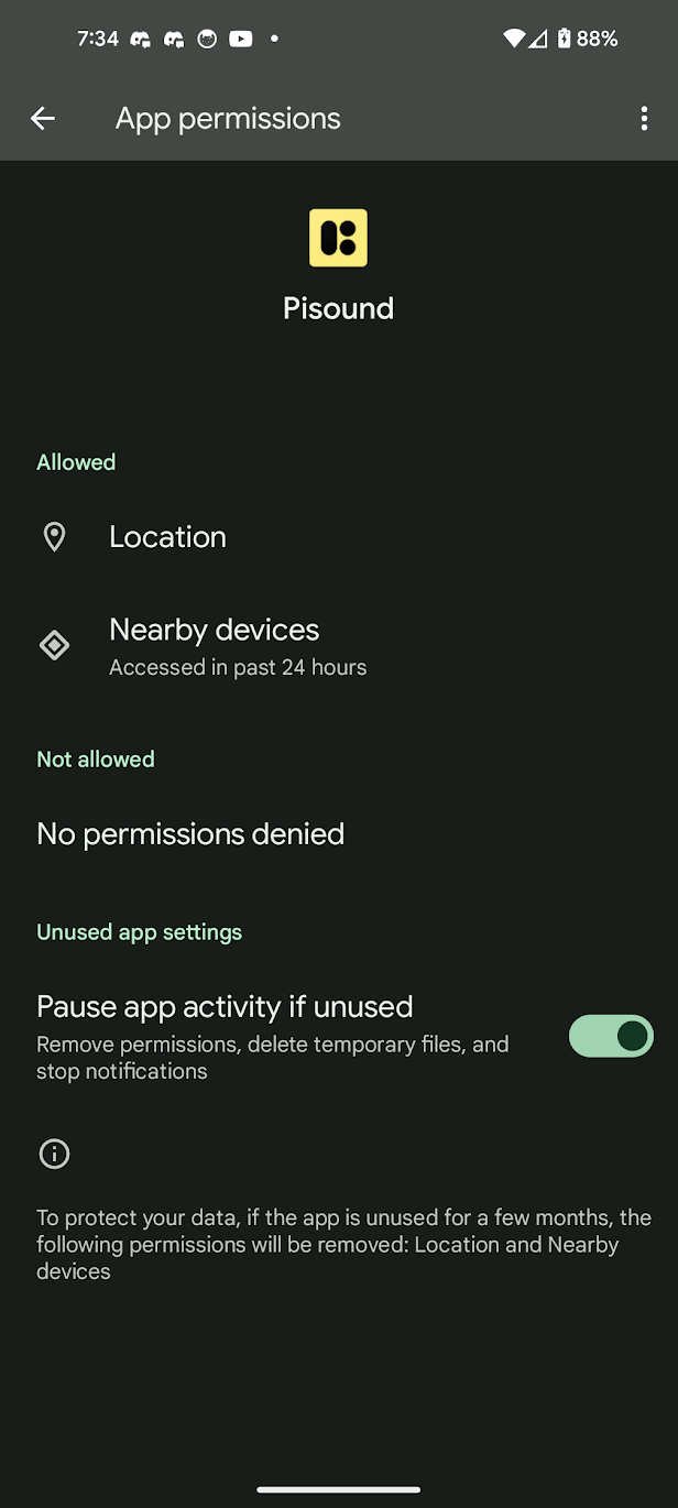

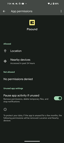

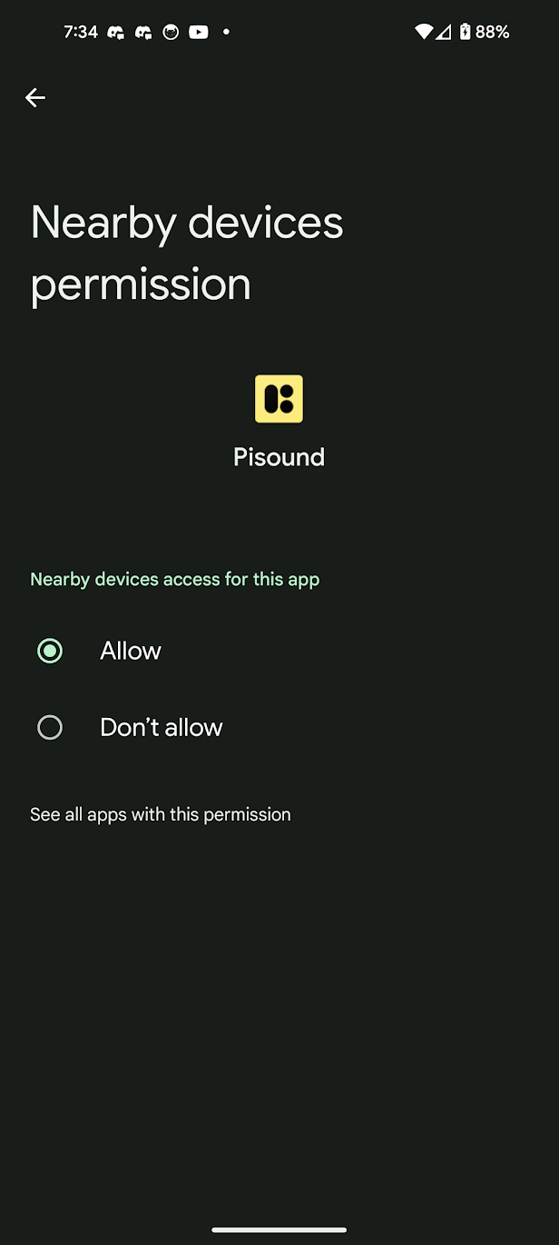

Mind you I DID read the instructions about enabling location services in other threads. Here’s what permissions look like:

Also, if you look at this Github issue for an unrelated project, someone in the thread notes that ACCESS_FINE_LOCATION is a newer permission for more recent Android versions. My Pixel 8 Pro is about as new as they come. Perhaps where it works are older phones or devices not issued by Google directly?
